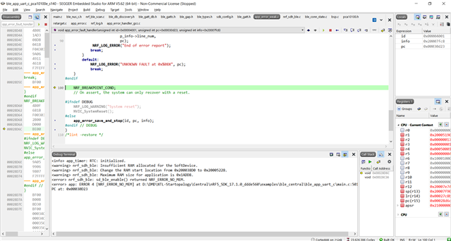

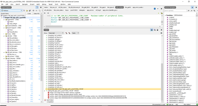

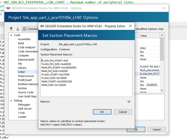

I modified ble_app_uart_c code to create multiple central connections instead of single central connection.
Here I am facing problem, once my central device is connected to peripheral getting fatal error. Checked my code with examples which are available in Nordic dev zone (with multicentral)  but the error is still exists
Attached my main file code and the debug output.
please help me out to solve this issue.

  • Hi Sudheer, welcome back.
    I can see from the log that you are building for Release. Could you please try again but build with the Debug option? The log would give more helpful options then.
    Please also double check if your setup is having any breakpoints. Your logs are somewhat similar to cases where users have problems due to an inadvertent breakpoint. Breakpoints will cause an application to crash when the application is using SoftDevice; that is due to how SoftDevice works.
    Hieu
  • Hi Hieu,
    thanks for reply,
    there is no breakpoints kept while debugging.
    Just build and debugged with "Debug" option instead of "Release", but still facing the same issue.
    please see the attached debug terminal output
    Sudheer
  • Hi Sudheer,
    Glad to see you solved your original question.
    Let's take a quick look at this next one. However, please know that if it is sufficiently different/complicated, I will have to request you to open a new ticket.
    I need two information:
    - Your memory setting configuration, where you changed the RAM start address.
    - Are you using only nRF52833 for this project?
  • Hi Hieu,
    thanks for the replay,
                  -please check the attached pic for Macro section placement
          - Yes, Actually we are planning nrf52833 for concurrent peripheral and central connections, for collecting and sharing the sensors(like Temperature, Humidity, etc.. ) data across the devices. always welcome if you  have any advice.
    sure, New ticket will open for further communication
    Sudheer
  • Hi Sudheer,
    One thing that stands out immediately is that the RAM start address should be 0x20005228 instead of 0x20005288.
    If that is intentional on your part, notice that
    • x5288 + x1ADD8 = x20060. That is more than the 128kB of RAM you have on the nRF52833
    • There is no need to give the SoftDevice more RAM than it asks for
    • Your application is basically running out of RAM as is.
    So please fix it. However, this is small and probably not what is causing you problem. Unfortunately I don't have the same issue using your main.c file on a nRF52832 with even smaller RAM. I assume you have just added some code to the application?
    I recommend you to take a look at this discussion:  Heap size .
    If that doesn't help, please open a new ticket, and one of our Tech Support team will be happy to help you.
    Best of luck,
    Hieu
  • Hi Hieu,
    Thanks for your support, It's working fine for me after changing the values of Macros section placement according nrf52833 RAM size
    sudheer
  • Hi Sudheer,
    Great to know. I have suggested my first answer about the SoftDevice max link configuration as the answer to the original question this thread is about. If you don't mind, please verify it as the answer, or I can also do it later :D
    Hieu
