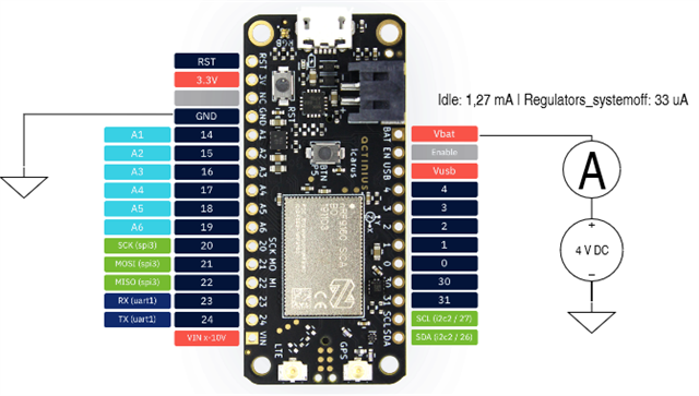

  • It is super basic. I attached pictures of two configurations I tried. The battery configuration seems to be the most efficient. When powering through the 5V port is seems to have a much higher Regulators_systemoff current, thats why I always took the battery configuration.
    I am using a standard multimeter (Voltcraft VC185), it can measure down to 0,1 uA.
    The fact that I can bring down the current to 33uA in battery configuration via software tells me, that there might be still a problem in software. But I am open for all ideas :)
    The nRf9160 mounted on the board is seen in this picture is revision B0. This is old and will not work with the newer modem FW and SDK. There is difference how the modem is turned on and off between the B0 and the newest B1 version. You can get a newer version if your board has the B0 one.

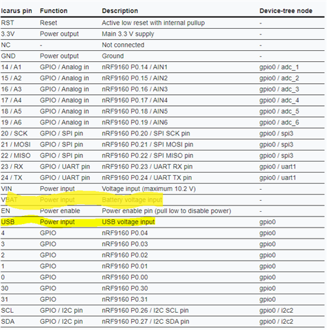

    Looking at the datasheet I think you can try to use VBAT as measurement place not USB.
    You can see USB is connected to FTDI chip, so its better not to power up that.
    Thanks.

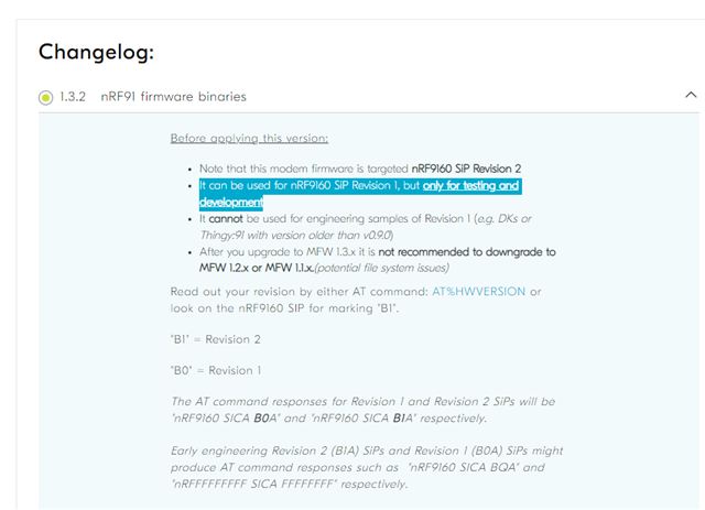

    You can check the compatibility matrix here (https://infocenter.nordicsemi.com/topic/comp_matrix_nrf9160/COMP/nrf9160/nrf9160_modem_fw.html?cp=2_0_3_5 ). Any MFW v1.2.x (or older) must be used with B0 devices.
    You can find this from changelog also from download page (Compatible Downloads - nordicsemi.com) for each version of modem FW. For example: MFW 1.3.2 can be used for nRF9160 revision 1, but only for testing and development.
