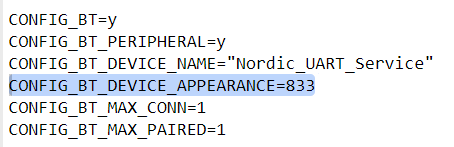

I would like to ask what is CONFIG_BT_DEVICE_APPEARANCE and what does the value 833 represent? Where can I find the values that can be assigned to this configuration?

  • In the context of Bluetooth configuration in software development, `CONFIG_BT_DEVICE_APPEARANCE` is a configuration parameter used to specify the appearance of a Bluetooth device. The Bluetooth specification defines a list of standardized appearance values that represent different types of devices. These values are used to provide additional context about the type of device to other Bluetooth devices during the discovery process.
    The value `833` represents a specific appearance value assigned to a Bluetooth device. In this case, `833` corresponds to the appearance of a "Sports Watch" according to the Bluetooth Assigned Numbers document (www.bluetooth.com/.../).
