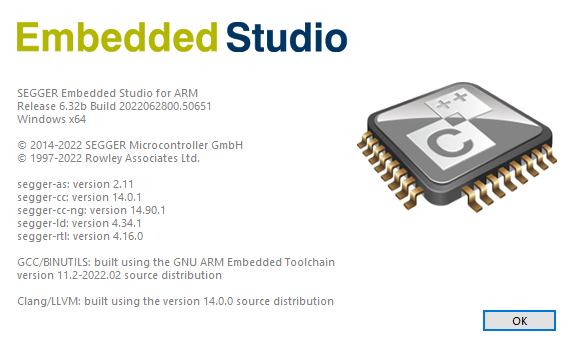

    Please let me know the toolchain setup you have.
    We do see an issue with newer toolchain (IDE/compiler) when compiling with our nRF5 SDK. Note that the SDK is now considered legacy and we stopped any new development for it since last year.

  • Hi
    My IDE / gcc info is below, let me know if you need any other details:
    Incidentally, this current effort started as a migration from a prior project on a nRF52840 that was originally on SDK 15.3 and s140 6.1.1 SD. I first updated this 52840 project to the same SDK17.1 / SD 7.2.0, which worked great with minimal/expected changes. AKA I wasn't able to reproduce these same issues on the nRF52840 with the same SDK/SD.
    It wasn't until I worked on migrating to the nRF52833 where I started running into problems, it is unfortunate there was no working dfu example to start from for this platform.
    I will note that I think I updated from SES version 4.22 (IDE used when I did the original 52840 project) to SES 6.32b right around the time when I started trying to port to the 52833 because debugging kept crashing on 4.22 on the 52833. It seemed like updating to 6.32b fixed this issue.
  • Hi Dan,
    It's recommended to use the exact SES version that we mentioned in the release note of SDK v17.1 , which is v5.42a.
    Please see here.
