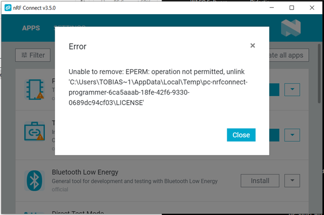

I used the apps from nRF Connect for Desktop for a project half a year ago. Today I started nRF Connect for Desktop and did the updates (automatic update for nRF Connect for Desktop to version 3.12 and manual updates for all utility programs e.g. BLE App, nRF Toolchain). After the updates completed, the programs from nRF Connect for Desktop do not start anymore. I tried nRF Toolbox and BLE App and both apps only show a loading circle animation but nothing ever happens. I tried reinstalling and it didn't help. The same problem still exists.
When I try to go back to nRF Connect for Desktop v. 3.5 and try to start BLE App I get the following error:
Am I missing something? How can I do a clean reinstall to fix these problems? I don't mind if I have to go back to an older versions. I just want it to work.

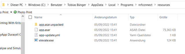

    thanks for your help. I created a new non-admin local user on my Windows 10 and installed nRF Connect for Desktop with that user and it works now on that user.
    Still I think this is something that should get patched because the old version worked without this problem.
    I didn't rename my user folder on my admin user because I didn't want to corrupt my profile and break all other already installed programs...
