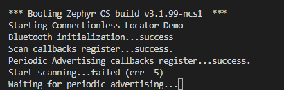

     We are working on nRF5340DK need testing procedure for direction finding (AOA, AOD). So far we have tried to Download and install nRF connect Application for Mobile (Redmi 11 pro plus supporting BT 5.2 & VIVO Y20g supporting BT 5.0)and tested without any luck (Unable to see anything wrt AOA/AOD ).  We have run direction finder connectionless RX in the board. The results is shown in the picture.
