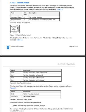

    I am using ESP32 as my provisioner. And I am giving the model publication state to be set to the provisioner through UART. Then ESP32 does the model configuration in my nRF device which is acting as a sensor server node. Yes, I did test it on the example SDK.
    Referring to the mesh documentation, I am setting the publish period as per the required format. Screenshot of the reference attached below.
