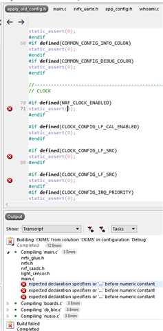

    I tried to implement the Advanced UARTE Driver library in the existing application, but failed on setting the NRF_CLOCK to enable nrf_drv_clock_lfclk_request. Adding the (relevant??) defines like NRF_CLOCK_ENABLED 1 in the app_config.h, I get errors in apply_old_config.h. expected declaration specifiers or '...' before numeric constant.

    As soon as I add one of the below line, the error is generated
    #define NRF_CLOCK_ENABLED 1
    #define CLOCK_CONFIG_LF_SRC 1
    #define UART_DEFAULT_CONFIG_HWFC 0
    #define UART_DEFAULT_CONFIG_PARITY 0
    #define UART_DEFAULT_CONFIG_BAUDRATE 30801920
    #define UART_DEFAULT_CONFIG_IRQ_PRIORITY 7

    The error comes from apply_old_config.h, as you said. It is included in nrf_glue.h and subsequently by nrfx.h, which is used in most if not all NRFX drivers.

    I inspected further and does not find apply_old_config.h looks like that in both nRF5 SDK v17.1.0, v17.0.2, and v15.0.0. Where did you pull this file from? What SDK version are you on?
    Anyway, if your apply_old_config.h looks like that, then the SDK you are on probably does not want NRF_DRV_CLOCK to be enabled while NRFX is being used.
    Meanwhile, libUARTE, as setup in the example, use App Timer (under the hood). The App Timer in turns relies on the LFCLK. Finally, the example uses NRF_DRV_CLOCK to enable LFCLK.
    Therefore, to avoid using NRF_DRV_CLOCK, we can just use NRFX_CLOCK to enable LFCLK instead. I cannot find an example which uses NRFX_CLOCK, so here is my code, tested and work:
