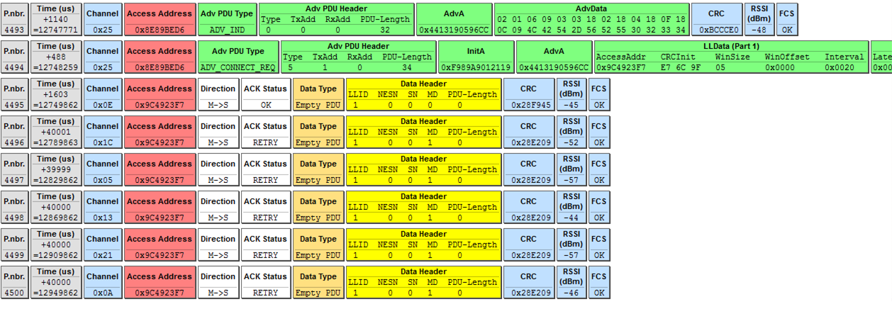

I'm working with a BLE central device using S120 which is base on ble_app_multilink_central source code. My problem is that I cannot connect to the peripheral ble tag device(specifically the device is LBT-VRU02 of Logitec). After sending the CONNECT_REQ ,S120 sends "Empty PDU" to the peripheral(LBT-VRU02), but no packet comes from the peripheral as follows.
image description
And BLE_GAP_EVT_DISCONNECTED event with reason code 0x3E is notified immediately after BLE_GAP_EVT_CONNECTED event.

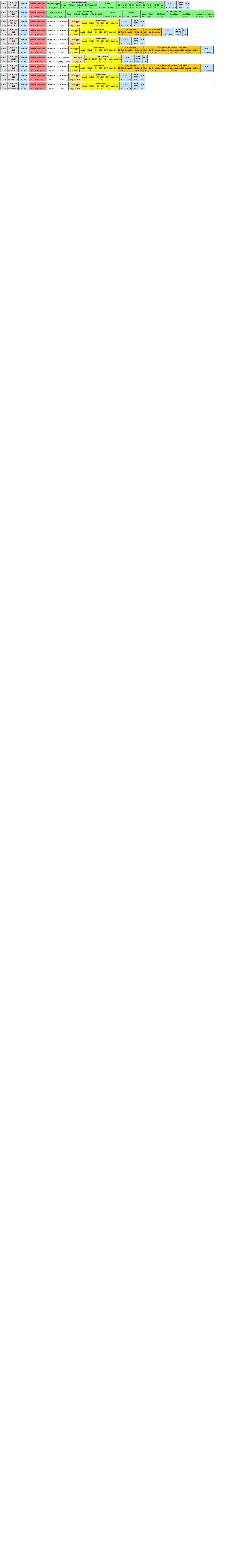

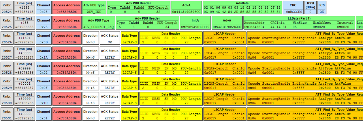

The Sniffer log of MCP is below: image description
I'm using a custom PCB for the my central and peripheral device. And I can connect the S110 peripheral device based on ble_app_multilink_ peripheral source code. I mean that my 120 central device can connect to the Nordic S110 peripheral device without problem.
I'm using the SDK v6.1 and S120 v1.0.0.
I have no idea what causes this problem. Can anyone help me?

    But, unfortunately I did not find any remeditaion. The sniffer log I got at the time is below.
    image description
    The BLE chip of the LBT-VRU02 is CSR100x or CSR101x.

    I assume that you are testing with MCP on PC. It's pretty strange because the stack on the dongle for MCP is very similar to S120 stack.
    There could be a chance that the LBT-VRU02 was advertising with whitelist. Could you double check that you have erased the bond information and LBT-VRU02 running in open mode.
    You can also try to test using the same dongle that you use for MCP. You can flash S120 and the application on the dongle and see if it manage to connect to the peripheral. Please send the full sniffer trace, for both cases.
