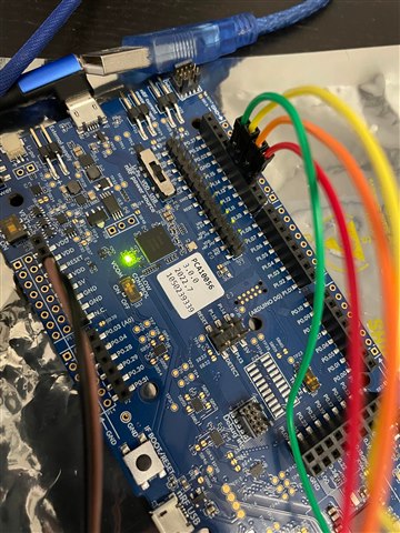

SPI connection to ADXL345 with Nrf52840
I'm trying to test a simple SPI communication between nrf52840 dev board and adxl345. I'm following this guy's youtube tutorial on segger embedded studio. Here's the code to read the device ID and also the hardware setup. I'm getting 242 instead of correct value of 0xe5 or 229. I'm not sure where it's wrong. I tested on an arduino uno and it works. Please help.
Thanks

    Can you try to increase the GPIO drive strength of the SPI pins by calling nrf_gpio_cfg() with drive parameter set to (NRF_GPIO_PIN_H0H1) after spi_init()? I have seen this solve similar issues in the past.
    Jørgen
  • Please try configuring the MISO pin as high drive as well. If that does not work, please check if lowering the SPI frequency will affect the results.
    Can you provide a logic trace/scope image of the communication on the SPI bus? Do the output and input look as expected?
  • Same result with MISO pin as high drive. I'm assuming we have to set it as INPUT? I don't have a logic trace/scope with me, It'll take me a while to get it sorted out. In the meantime, what are your thoughts on the problem?
     nrf_gpio_cfg(SPI_MISO_PIN,  NRF_GPIO_PIN_DIR_INPUT, NRF_GPIO_PIN_INPUT_DISCONNECT, NRF_GPIO_PIN_NOPULL, NRF_GPIO_PIN_H0H1, NRF_GPIO_PIN_NOSENSE);
  • I just tried out with SPI_MODE_3 and it seems be working. I don't know why it wouldn't work with SPI_MODE_0. Any thoughts?
