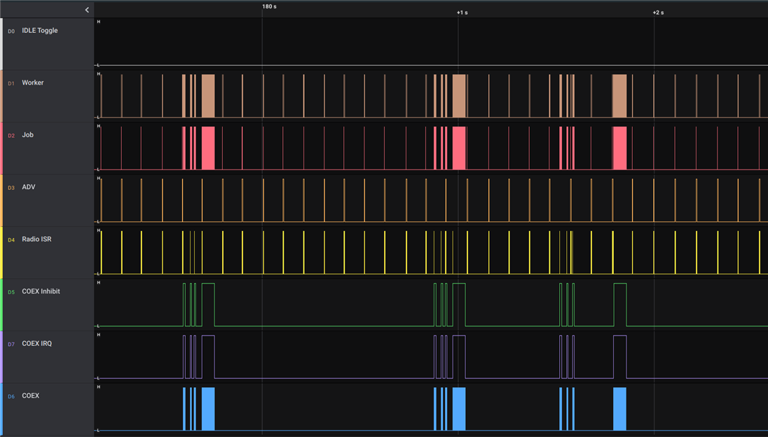

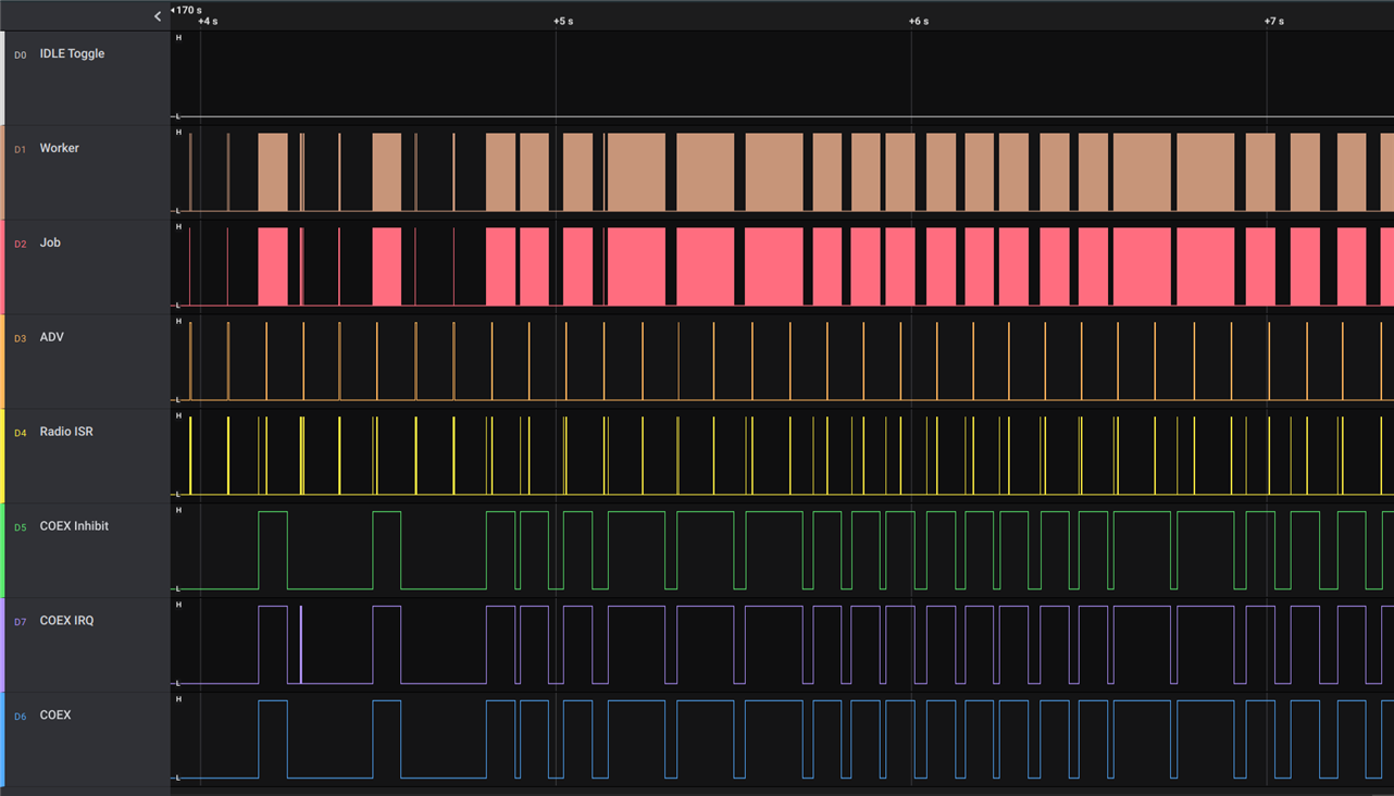

  • I have tested the COEX2=4 mode using logic analyzer. I found out that the the modem TX mode in poor signal conditions is taking a large amount of bandwidth shared of the device.
    In this state the Bluetooth will became unusable due to limiting the windows for its transmissions. (The image contains both cases for Poor and Good signal, enlarge for view)
    The Modem firmware needs to have some option to give the Bluetooth time to transmit required data, or enable the Input functionality of the COEX0
    How should we proceed with this ? I believe that the same issue must have been observe, when the Coexistence feature for the SoftDevices controller were developed. How did you solve this issue?
    What is the modem doing in this plot? Is it an RRC connection, or just listening for pages?
    As you point out, under poor conditions, you probably have multiple repetitions, which will increase the radio usage. Repetitions etc. are configured by the network, so it is limited what you can do. One suggestion is to have a look at %CONEVAL. This command could give the application the information it needs to decide if sending data would cause coexistence issues.
  • The modem at this point was trying to transmit packets to the server. Is there an option how to configure the maximum number of repetition or some delay between them ?
    The Bluetooth operation would definitively be disrupted by this behavior.
  • This is result of %CONEVAL when the LTE signal is poor and the modem is taking too much "Air" time for TX operations. You can evaluate the behavior of the COEX pin of nrf9160 down on the screenshots from the analyzer. COEX2=4 Mode.
    %CONEVAL: 0,1,5,8,7,19,"000D951F","23003",306,6447,20,0,1,23,32,8,160
    %CONEVAL: 0,1,5,8,7,19,"000D951F","23003",306,6447,20,0,1,23,8,8,160
    %CONEVAL: 0,1,5,9,9,20,"000D951F","23003",306,6447,20,0,1,24,8,8,159
    %CONEVAL: 0,1,5,8,7,18,"000D951F","23003",306,6447,20,0,1,24,8,8,160
    %CONEVAL: 0,1,5,9,9,19,"000D951F","23003",306,6447,20,0,1,24,8,8,159
    These are when the modem has good signal.
    %CONEVAL: 0,1,5,36,19,29,"000D951F","23003",306,6447,20,0,0,23,32,8,132
    %CESQ: 36,1,18,2
    %CONEVAL: 0,1,5,37,19,29,"000D951F","23003",306,6447,20,0,0,23,32,1,131
    %CONEVAL: 0,1,7,37,21,29,"000D951F","23003",306,6447,20,0,0,23,1,1,131
    %CONEVAL: 0,1,7,37,19,29,"000D951F","23003",306,6447,20,0,0,23,1,1,131
    What can be done to ensure that the BT will have enough "Air" time to work ?
