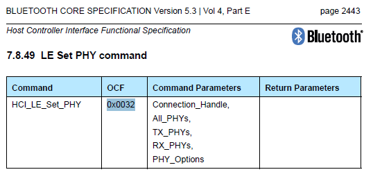

W:opcode 0x2032 status 0x11
PHY update Failed: -5
This is the same result i get when i added the bt_conn_le_phy_update()  function to my code
The device appears to be running in coded Phy since i need to set my wireshark to coded to see the advertisement and connection information.
but what coded version is it running S=2 or S=8?
also, why does the update_phy function fail?
  • W:opcode 0x2032 status 0x11
    The opcode is 0x2032. We need to convert it to binary first. 0x2032 = 0010 0000 0011 0010. So the first 6 bits represent the OGF, which is 0x08 in this case. And the last 10 bits represent the OCF, which is 0x32. With this we can find the corresponding HCI command in the core spec, and that will be le_set_phy:
    From BT core spec I can find that the status code 0x11 is:
    So basically this means that when trying to call le_set_phy that it return Unsupported.
    In this case it sounds like coded phy is not supported, so I suggest to try in prj.conf:
    CONFIG_BT_CTLR_PHY_CODED=y
    Does this help?
  • Thanks  I added that to the Project and it no longer gets an error.  I then added the same to my code and i get the error.  I will look for the differences in m code and the throughput example to see why it throughs an error.
