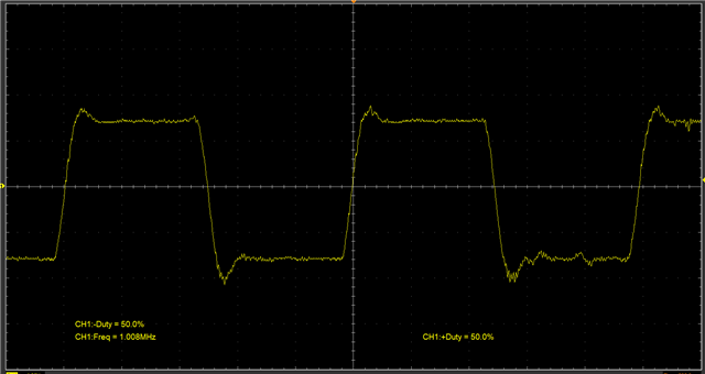

I am attempting to use my nRF52810 (testing with the nRF52 DK) to generate square waves using PWM. Ideally, these square waves would operate at 8 or 16Mhz. So far I have used the base pwm_library and pwm_driver examples provided in the sdk to test this but have some uncertainty how to do it. I have been able to produce square waves with 50% duty cycles, but it seems that the frequency tops out at 1Mhz.
When using the pwm_library, it seems as though the lowest period I can set is 1us (1Mhz). However I cannot provide a period less than 1us or the pwm output is blank. I have stepped through the code a bit to understand how it works, but unsure how to achieve a higher frequency output.

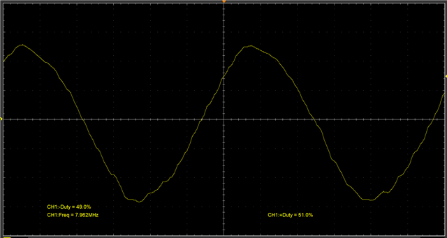

  • Thanks for the help Sigurd. Very helpful and much appreciated.
    Would just like to confirm that 8Mhz is the highest frequency achievable. There is no way to generate a higher frequency (16Mhz)?
    I used the example you linked above and was able to generate a 8Mhz waveform.
    Is there any way to adjust the waveform shape so that the output is more square? Additionally, can the amplitude of the waveform be adjusted?

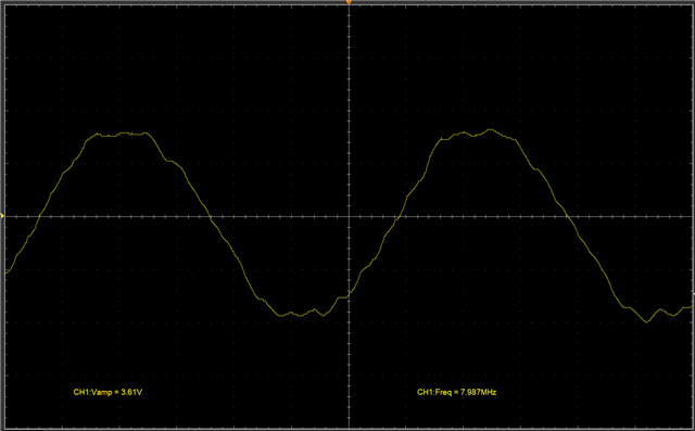

  • Thanks for the follow up Sigurd.
    Setting the GPIO pin in high drive mode makes the waveform "more square." But a bit more of a clipped sine wave than a square wave. It also increases the amplitude too.
