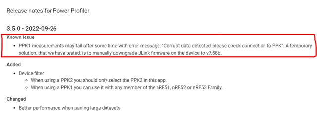

Power Profiler 3.5.0 crashes when re-starting measurements
I've used the PPK2 for a while now, but as of today it started crashing whenever I re-start a current measurement. Both in Source / Ampere meter mode.
The logging says:
09:17:30.927 Using nrf-device-lib-js version: 0.4.13
09:17:30.927 Using nrf-device-lib version: 0.12.8
09:17:30.927 Using nrfjprog DLL version: 10.16.0
09:17:30.927 Using JLink version: JLink_V7.66g
09:17:30.991 Installed JLink version does not match the provided version (V7.66a)
09:17:33.350 Validating firmware for device with s/n DF222A76BBE4
09:17:33.359 Opening device with s/n DF222A76BBE4
So the only think noticable is the JLink version warning. How can I get more info on this?
