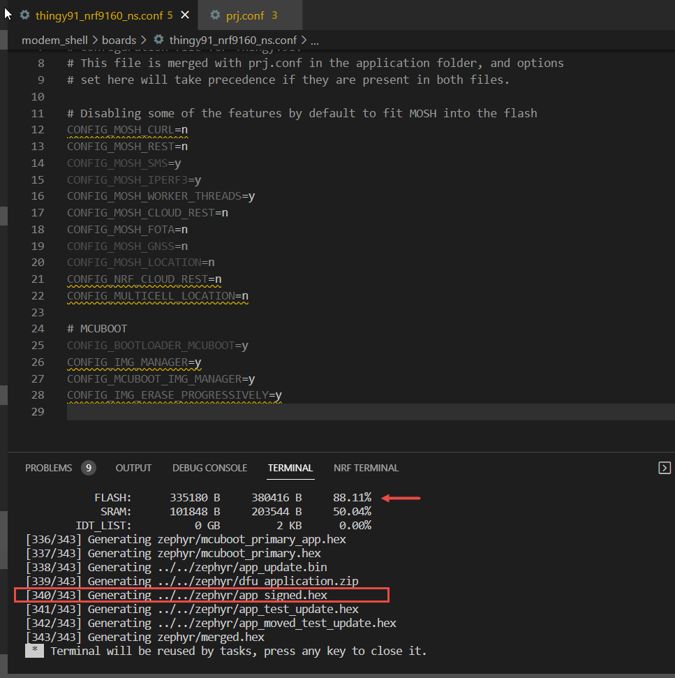

For network testing, I would like to use the Modem Shell App sample with the Thingy:91.

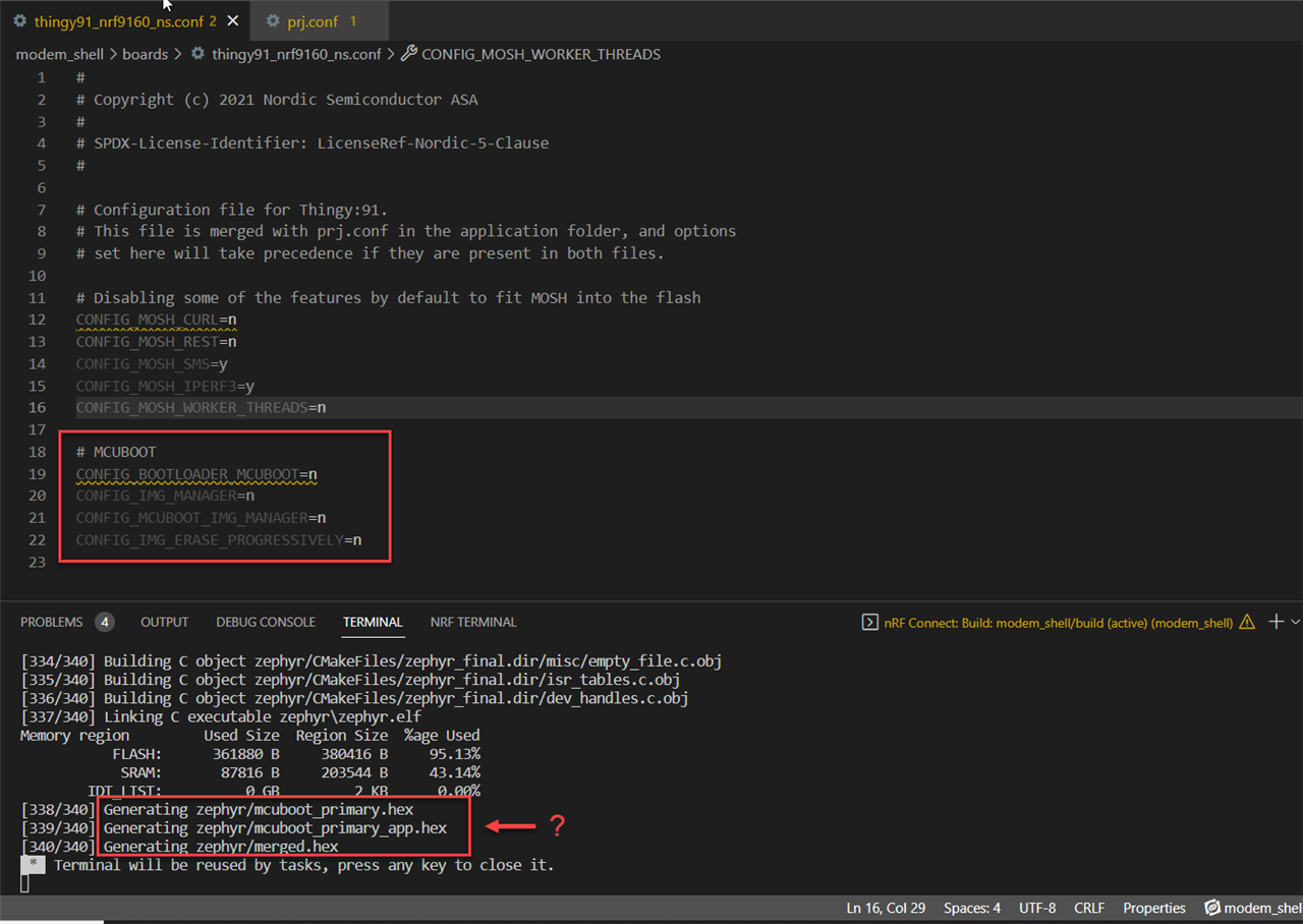

As suggested in the overlay file, I can disable some features, so the Build can fit the application memory. But, if the MCUboot is disabled, is there a way to flash the applications (.hex below) to the kit without using a debug’s probe? For instance, using FOTA feature?
Otherwise, which features are you recommending disabling in the prj.conf, so I can have the following tools in the same build: LTE link control, AT commands, Ping, Iperf3, SMS tool and Socket Tool?
Thanks a lot!
Bernard
  • Hello Bernard,
    MCUBOOT is needed for both FOTA and programming via USB on the Thingy:91. If you do not need location services, then you could try the following settings in the thingy91_nrf9160_ns.conf overlay
    # Copyright (c) 2021 Nordic Semiconductor ASA
    # Configuration file for Thingy:91.
    # This file is merged with prj.conf in the application folder, and options
    # set here will take precedence if they are present in both files.
    # Disabling some of the features by default to fit MOSH into the flash
    CONFIG_MOSH_CURL=n
    CONFIG_MOSH_REST=n
    CONFIG_MOSH_SMS=y
    CONFIG_MOSH_IPERF3=y
    CONFIG_MOSH_WORKER_THREADS=y
    CONFIG_MOSH_CLOUD_REST=n
    CONFIG_MOSH_FOTA=n
    CONFIG_MOSH_GNSS=n
    CONFIG_MOSH_LOCATION=n
    CONFIG_NRF_CLOUD_REST=n
    CONFIG_MULTICELL_LOCATION=n
    # MCUBOOT
    CONFIG_BOOTLOADER_MCUBOOT=y
    CONFIG_IMG_MANAGER=y
    CONFIG_MCUBOOT_IMG_MANAGER=y
    CONFIG_IMG_ERASE_PROGRESSIVELY=y
    Øyvind
  • Hello Øyvind,
    Thank you very much for the quick response. I confirm the build is now working with all requested features.
    Bernard
