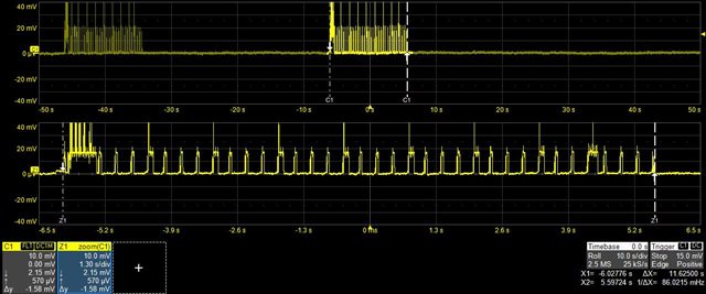

I'm doing a comparison between MQTT on TCP and CoAP on UDP over NB-IoT and LTE-M. The communication to the cloud works as expected for both protocols. MQTT is used with TLS and Coap is used with DTLS.
Now the next step is to get an impression of the power consumption for both protocols in certain scenarios. But what I saw on the oszilloscope is not what I expected (see screenshot below). Every time I transmitted a packet to the cloud it took more than 10s until the modem went into the sleep mode again. But the response to a request packet has been received much earlier in case a response was expected.
What I can see in the LTE Link Monitor is that the modem outputs "+CSCON: 1"  every time the high power consumption time starts and it outputs "+CSCON: 0" every time it goes into the sleep mode again (after more than 10s).
The picture below shows a screenshot of the MQTT communication but the same applies to CoAP.
For the test in the picture above I used PSM mode with the following configuration (eDRX has been deactivated)
  • CONFIG_LTE_PSM_REQ_RPTAU = 1h
  • CONFIG_LTE_PSM_REQ_RAT = 3s
From what I read in this post the reason for this behavior is that the modem is still in RRC_CONNECTED for a serveral seconds although the communication has already been finished.
https://devzone.nordicsemi.com/f/nordic-q-a/81278/early-release-assistance-indication

    Produces the missing Release Assistance Indication the behavior I discovered in my description above?
    That is quite possible. Have you tried to enable it to see if it makes a difference?

  • OK, after a few days of bugfixing now CoAP communication with RAI works as expected. I still have to investigate time into some other issues but for now I can send a CoAP request packet to the CoAP server, wait for a ACK response and set the whole nrf9160 SiP into sleep mode (PSM) right after I have received the CoAP ACK response. The same applies if I use eDRX.
    I did it the following way in case other people need a hint how to start with RAI.
    First, I called the following sequence at the beginning of my test application.
    lte_lc_init();
    nrf_modem_at_printf("AT%%REL14FEAT=0,1,0,0,0");
    lte_lc_connect();
    nrf_modem_at_printf("AT%%RAI=1");
    Note: the sequence above is of course only a simplified description.
    After that I set the following option every time right before I sent a socket packet. Of course the "SO_RAI_ONE_RESP" option needs to be adjusted to your needs.
    setsockopt(socket, SOL_SOCKET, SO_RAI_ONE_RESP , NULL, 0);
    Note: I only tested it for NB-IoT in my region and the sequence I discribed above is not optimized.
