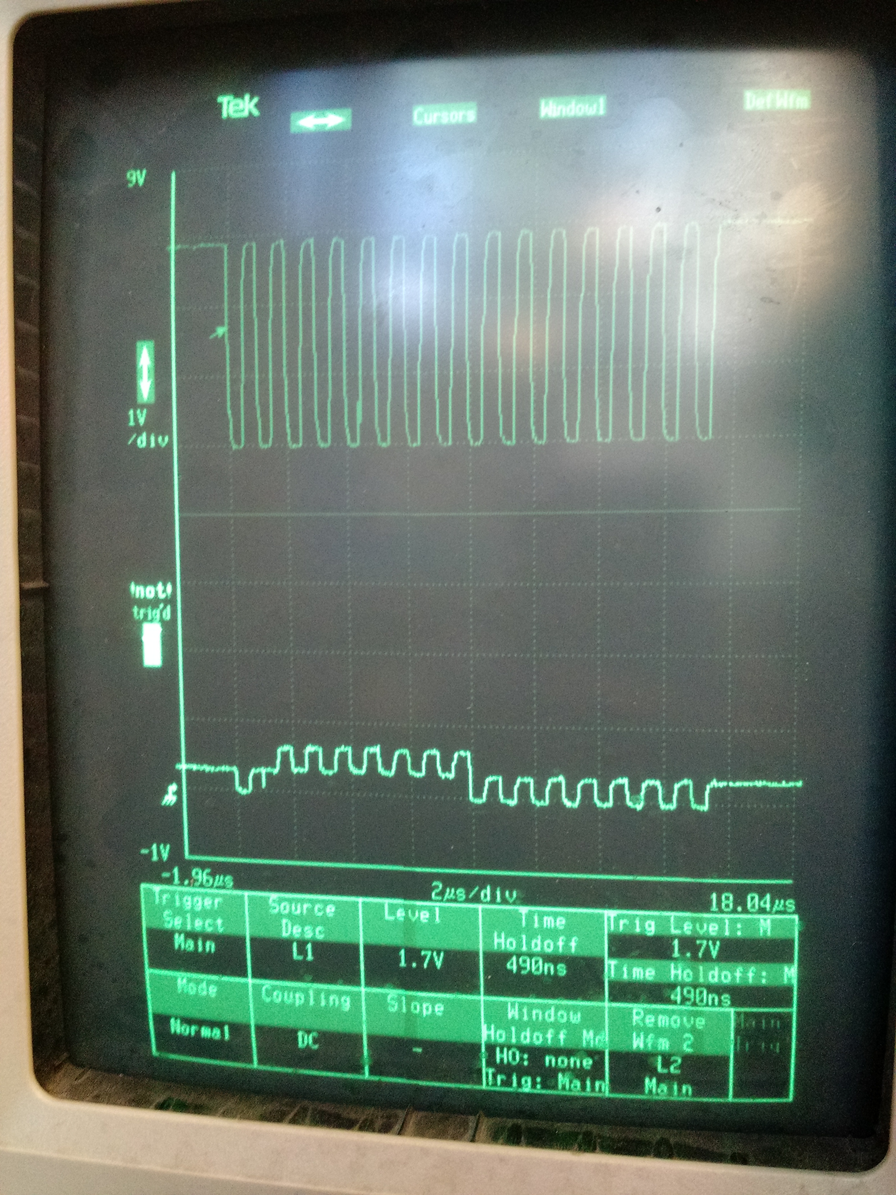

So I have verified with an oscilloscope that the clock signal is actually being output, and that pin, 4 in my case, and that the MOSI is sending the correct data on pin 29. It is the MISO that is not working. I thought at first it was that the pin was not configured as an input, so I did so, but the data edges are not correct in that they don't go high enough as seen on the scope trace below (top signal is CLK, bottom is MISO):
image description
I have tried various configurations of the input pin (NOPULL, PULLUP, PULLDOWN), same result.

I need help understanding two things:
1) Why does the MISO seem to not work, electrically AND
2) Why does the program persistently create an error condition. It does the first nrf_drv_spi_transfer() call okay, but trying another call creates an error condition that halts to program.

  • Hi
    1. I agree with you that the "double definitions" are confusing. I have reported it to our SDK team.
    2. As I'm sure you know MISO is Master Input/Slave Output meaning it is the slave that is driving the line. Hence, my suspicion is that your slave is not working or configured properly. The MISO pin on the nRF52 should be properly configured by the drivers. The waveform you see might be some sort of interference from the MOSI or CLK line.
    3. I suspect that this is because there is a function call to check_buf_equal() inside the spi_master_x_event_handler(). This function is comparing the TX and RX buffers and if they are not the same the function will return an error condition. So, if you have not removed these two lines:
      result = check_buf_equal(m_tx_data_spi, m_rx_data_spi, TX_RX_MSG_LENGTH); APP_ERROR_CHECK_BOOL(result);
    and if you are not doing a loopback or a have slave device that returns exactly what it receives your application will stall in the app_error_handler() function. If you have already taken care of this it might be because you are trying to transmit too fast and the SPI module is busy. This is a quote from the nrf_drv_spi_transfer() documentation:
    If an event handler was provided in nrf_drv_spi_init() call, this function returns immediately and the handler is called when the transfer is done.
    In other words, if you are using an error handler like spi_master_x_event_handler() and you don't make sure that the SPI is not busy before you start another transmission then nrf_drv_spi_transfer() will return NRF_ERROR_BUSY.
