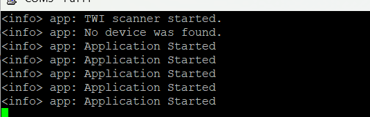

    The MPU was powered and i have built 1 project before to test the response of TWI it's work normally, but the init of MPU is fail, idk why?

  • Hello Kyle,
    Does the TWI from the nRF work normally, or does the TWI on the MPU work normally?
    The screenshot of the log in your last reply, is that from the SDK\examples\peripheral\twi_scanner example, or is it from your nrf5-mpu-simple application?
    Either way, it suggests that no TWI devices are connected correctly. At least not that the nRF can see.
    Did you try to analyze the TWI bus using a logic analyzer? Does the MPU send a reply?
