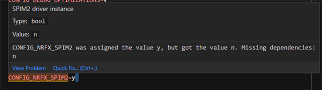

I'm using SPIM2 for an external accelerator, and I wanted to set it up.
I insert all as requested, but compiling it says me:

This seems to be an error coming from the define
#ifdef CONFIG_NRFX_SPIM2
#define NRFX_SPIM2_ENABLED 1
As the CONFIG_NRFX_SPIM2 is not defined, it's not included into the enumerator oh nrdx_spim.h and so it causes an error.
The problem is that I activate the SPIM2 using KCONFIG define but it seems it doesn't work...
Do you know how to go out of this trouble?
I don't want to add the define manually.
on manuals, SPIM2 is present into nRF52840
