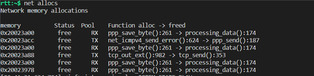

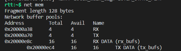

Memory allocation problem after successive MQTT connections with TLS
After repeated mqtt connection-disconnection processes,I have the problem of code -12 and it is impossible to connect with the MQTT broker after that, the issue is similar to this post.
The mqtt connection code was based on the google_iot_mqtt example because we were using "GCP IoT Core" as a broker at the beginning of the project development.
I was able to verify in the debug logs that the error is thrown in the mbed TLS library as you can see in the log below.

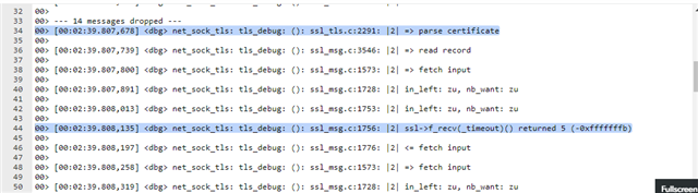

00> [00:02:41.388,549] <err> net_sock_tls: TLS handshake error: -4290
00> [00:02:41.393,859] <dbg> net_sock: z_impl_zsock_close: (): close: ctx=0x20006bb8, fd=0
00> [00:02:41.393,920] <dbg> net_sock_tls: tls_debug: (): ssl_msg.c:5378: |2| => write close notify
00>
00> [00:02:41.393,981] <dbg> net_sock_tls: tls_debug: (): ssl_msg.c:5394: |2| <= write close notify
00>
00> [00:02:41.399,475] <dbg> net_sock: z_impl_zsock_close: (): close: ctx=0x20007838, fd=1
00> [00:02:41.399,536] <err> my_mqtt: could not connect, error -113

00> [00:02:45.578,674] <dbg> net_sock_tls: tls_debug: (): ssl_tls.c:3280: |1| alloc(zu bytes) failed
00>
00> [00:02:45.578,704] <dbg> net_sock: z_impl_zsock_close: (): close: ctx=0x20006bb8, fd=0
00> [00:02:45.579,254] <dbg> net_sock: z_impl_zsock_close: (): close: ctx=0x20007838, fd=1
00> [00:02:45.585,144] <err> my_mqtt: could not connect, error -12

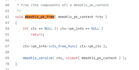

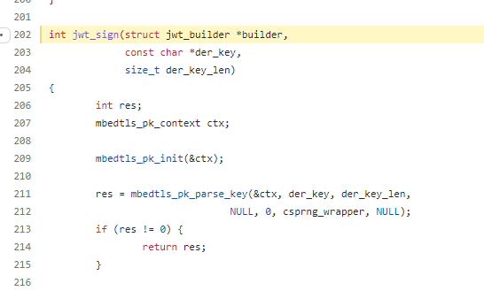

            err = jwt_sign(&jb, zepfull_private_der,
                    zepfull_private_der_len);
            if (err != 0) {
                LOG_ERR("Error with JWT token signing: %d",err);
                return;
		/* MQTT client configuration */

    Looking at your log, I can see MQTT broker can not be connected and also there is TLS handshake error. It could be a cause that server is not connected to client as communication can not verified between two. May be certificate is expired.
    You can see in the log ([00:02:39.808,135] <dbg> net_sock_tls: tls_debug: (): ssl_msg.c:1756: |2| ssl->f_recv(_timeout)() returned 5 (-0xfffffffb)) after parsing certificate there is timeout error.
    You need to solve these issued first. The error seems to happen in Zephyr's socket library. Are all the sockets are not properly closed on your  side?
    You can try to check with zephyr community: https://docs.zephyrproject.org/latest/develop/getting_started/index.html#asking-for-help
    Thanks.

    About the sockets, I believe I'm closing correctly, because all the disconnections I do are using the mqtt_disconnect method, I even tried using mqtt_abort but the problem persists.
    I would even like to ask if there is any way to monitor the memory usage on the TCP connection, today I am using the shell commands:
    - net mem
    - net allocs
    In both it seems that there are no open sockets, I will attach two images containing the response of these commands right after the problem occurs
    What I notice, is that there seems to be something wrong in mbed TLS, as after the problem starts, any action I try to do in mbed TLS returns me memory allocation error (for example, in signing jwt). Is there any way to check the mbed TLS heap at runtime?

  • Hello Yago,
    Sorry for the late reply.
    It could be a memory leak in the  jwt.c module from zephyr in the jwt_sign() function (sdk-zephyr/jwt.c at main · nrfconnect/sdk-zephyr · GitHub)
    You can see that it works with the mbedtls_pk_context structure but it does not free allocations when exits, because the free unction is not called when it is done. As a result, after a few iterations there might not enough heap for the actual handshaking to be succeed. So, jwt_sign() should call mbedtls_pk_free() after execution (mbedtls/pk.c at master · wolfeidau/mbedtls · GitHub).
    Thanks.
