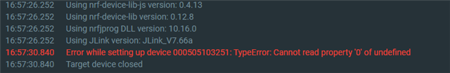

JLink typeError : Connaot read property '0' of undefined
Hello Community, i'm currently working on a custom board based on BC40C which is a BT/BLe module based on nrf5340
i'm trying to debug my board with jLink ultra + under, i'm using Nrf connect v3.12.0
i'm encoutring a problem with my jLink when trying to program my custom board
that i can't get my program written on my board
i trying version upgrade as io found it like a solution on the forum but it didn't help much
can you provide me with useful help please on how can i solve this error
thank you in advance

    What's an "under" ?
    Which nRF Connect Desktop application are you using? The programmer app, which version of it?
    Can you share the entire log?

    thanks for referring to me
    i'm was working on V 2.0.3 on programmer and the version 3.12.0 on nrf connect for Desktop
    infact updating nrf connect version didn't help
    but later i tried updating the programmer version to V3.0.4 and it's working and loading the solution perfectly on my custom board
    here's the successful log
