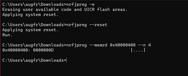

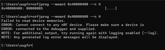

  • Hi August,
    Could you try to read the RESETREAS register in order to check if the RESET pin was enabled somehow?
    -Priyanka
