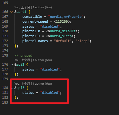

It works when button0 is the pin of gpio0.
&button0 {
    gpios = <&gpio0 12 (GPIO_PULL_UP | GPIO_ACTIVE_LOW)>;
When it is the pin of gpio1, it does not work.
&button0 {
    gpios = <&gpio1 13 (GPIO_PULL_UP | GPIO_ACTIVE_LOW)>;
