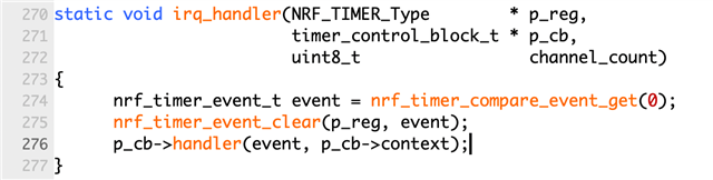

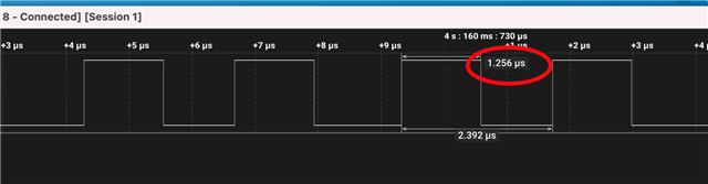

I'm trying to generate a 1 MHz base clock with one of the peripheral timer, and in the timer ISR does some GPIO toggling.
I followed the nRF5 SDK example and just toggle one GPIO in the ISR to test the clock frequency. I notice, for some reason, the fastest clock I can get here is ~100 kHz (10.6 μs period).
Would you help me check what I did wrong?

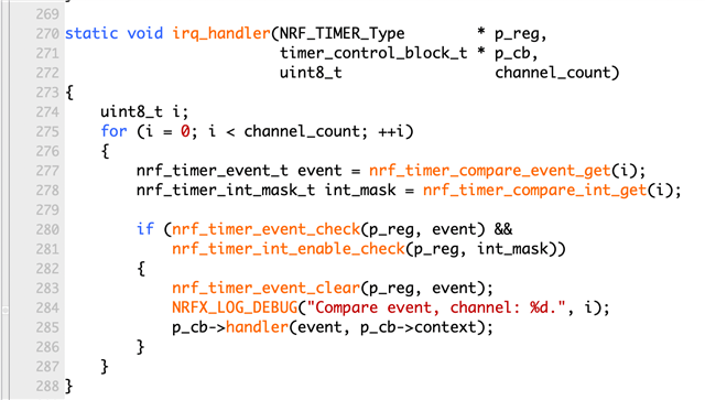

And here is the timer irq handler
static void timer_irq_handler(nrf_timer_event_t event_type, void *p_context)    // Timer handler is only used in timer mode not counter mode
  switch(event_type)
    // case NRF_TIMER_EVENT_COMPARE0:
    //   nrf_gpio_pin_toggle(BSP_LED_1);
    //   break;
    case NRF_TIMER_EVENT_COMPARE1:                                              // The event type is based on the timer setting
