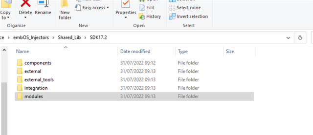

  • Do you have a folder containing the SDK on your computer? If so, what do you see inside the folder:
    SDK\examples\dfu\secure_bootloader\ ?
    2,3: Using the bootloader to transfer the appliaction image that you generated using nrfutil, or using a programmer to program the application's .hex file directly?
  • this is what in my SDK 17.2 folder
    2,3 i used nrfutil to the bootloader ttranferation

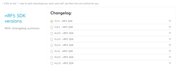

  • We do not have a SDK17.2 release.
    Our latest nRF5 SDK release is SDK17.1.0:
    Also, I see that you don't have the "examples" folder. Where is your bootloader project located?
    2,3:
    So you mean transferring an application image, using the bootloader then. I assume you are using a BLE bootloader, since you said "how can i know that the BL SW received all the BLE package" in your original post. The BLE stack will handle retransmissions, so you don't need to worry about that.
