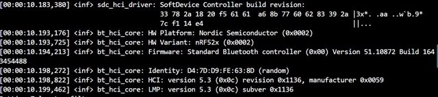

Short description:   After establishing a BLE connection between two nRF52840 based boards (both running Zephyr) and starting data transmission (one transfer about every 500 ms), the connection disconnects with reason 0x08 (timeout)
More detail:
System:   A "sensor" board communicates with a "repeater" board which forwards packets to an Android device.   Communications between the sensor and repeater are "coded PHY" BLE.    Communications between the repeater and Android device are currently also coded PHY (but may not be in the future).
Sensor: Sensor custom board based on Laird BL654PA (nRF52840 with power amplifier) using Zephyr (Zephyr OS build v3.0.99-ncs1-1 as distributed in nRF Connect SDK 2.0.2).   There is an external 32 kHz crystal supporting the BL654PA.     The following image shows the SoftDevice log entry from Zephyr when it starts:
Repeater: Repeater custom board will also be based on Laird BL654PA, but for now is emulated using nRF52840-DK.   It also uses Zephyr (same version) with same SoftDevice.   The nRF52840-DK also has a 32 kHZ crystal.

    It sounds like you have understood the error correctly. Error 8, or BT_HCI_ERR_CONN_TIMEOUT, is raised by the lower layer of the Bluetooth stack if it stops receiving packets from a connected device for longer than the supervision timeout. And this is the disconnect reason you can expect to see if one of the devices is moved out of range, for instance.
    From other posts you may have seen that excessive drift on the 32 KHz can lead to intermittent connection problems like this. An easy way you can rule out this as a possible root cause is to repeat the test with the LFSYNT  clock instead (selected through CONFIG_CLOCK_CONTROL_NRF_K32SRC_SYNTH - you will want to select this on both the repeater and sensor board for this test).
    Do you have logging from both boards? I'm basically wondering if you will detect if one of the boards is reset while connected due to an error, etc.. This will almost always lead to a BT_HCI_ERR_CONN_TIMEOUT on the other side of the connection.
