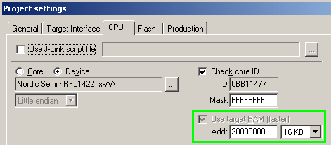

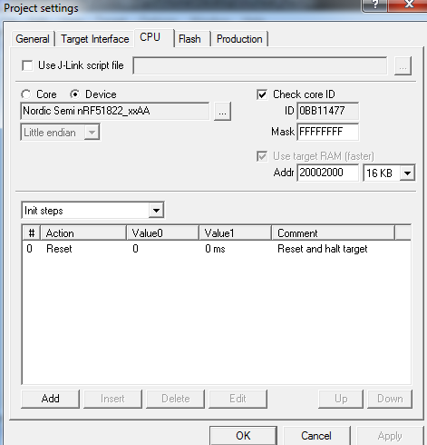

I have a nrf51822 chip that I would like to flash using Segger Flasher in Stand-alone mode. When I am trying to load the program to the chip I get the following error:
"Programming and verifying target (39448 bytes, 1 range) ...
  • ERROR: RAM check failed @ address 0x20002000.
  • ERROR: Write: 0x03020100 07060504
  • ERROR: Read: 0xFFFFFFFF FFFFFFFF
  • ERROR: (0 bytes of RAM have been checked successfully)
  • ERROR: Failed to program and verify target"
I have verified the connections by using nrfjprog and the flasher to flash the device. I have chosen the nrf51622_xxaa_s110 and is using the s110 SD. I have followed the instructions in the user guide for flasher.
image description
Here is a picture of the CPU settings. Anyone see any errors?
