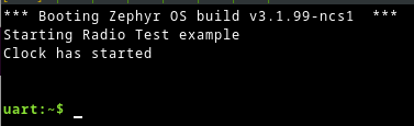

    For instance radio_test (nrf/samples/peripherical/radio_test) would only requires to add in the device tree (or overlay) rts-pin, cts-pin and hw-flow-control?
    Thanks!
    Benjamin
  • Yes, the part about enabling flow control in the overlay file applies to other samples as well. (You can see it used a lot in the SDK if you search for "hw-flow-control" in all "*.overlay" files.)
