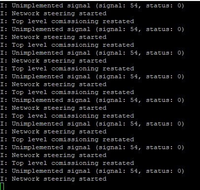

Hi,i have start with light blub and network coordinator examples. But i have got an message like that on the coordinator terminal.
And my light bulb terminal also have a Unimplemented signal error. So what is wrong with those ?

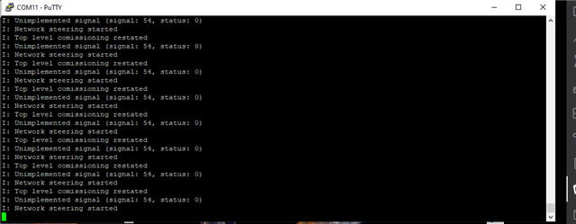

Also i have tried the coordinator example with shell.
i have write this commands to the shell
> bdb role zr
> bdb start
And my coordinator screen like this :
Also my shell screen is here:
Those are the example and i didnt change anything. But i guss there is a problem.
"Unimplemented signal (signal: %d, status: %d)" does not necessarily mean that there is an error. It is printed when a signal that is not handled in the signal handler (zboss_signal_handler) is generated. You can find a list over all the signals in ZBOSS commissioning signals handler if you look under the section "Signals passed to zboss_signal_handler()". As you see there signal 54 is ZB_NWK_SIGNAL_PERMIT_JOIN_STATUS, which means that the network was just closed or opened.
