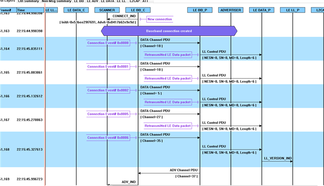

Hello, I found that my device is more prone to disconnection due to 0x8. And I saw the log and found that most of the disconnected cases were immediately disconnected as soon as they were connected. I captured some air packets, please help to analyze, thank you!

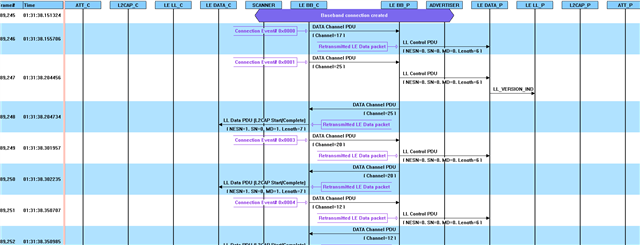

Here is a partial air packet I captured
22:15:52

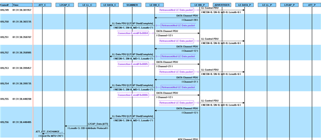

another : 01:31:42
    Disconnect reason 0x08 means that what you are seeing is a supervision timeout. Basically it means that (at least one of) the devices hasn't picked up any packets from the connected device for CONN_SUP_TIMEOUT time. Looking at your traces, it looks like there are only retransmissions, so it looks like that is the case.

    I don't think changing the connection parameters (the ones that happen after 5 seconds) will have any effect. Based on the log, it doesn't look like it receives any packets from the nRF. I am not entirely sure what device we are seeing in the trace. I have not seen this software before. Is that packets from the phone or the nRF?

    These pictures were captured and analyzed using the Frontline sodera analyzer.
