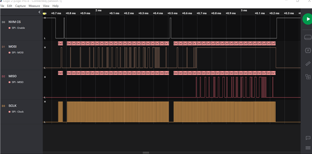

NVM process on SPI bus seems to be interfered with during BLE_GATTS_EVT_WRITE event
During an execution of a  winbond w25q64jv command (any command) during a BLE_GATTS_EVT_WRITE event the SPI bus goes inactive after the command is sent:
There is apparently no issue if I do any NVM operation outside a BLE_GATTS_EVT_WRITE event.
    What does the logic analyzer look like if you do it outside the BLE_GATTS_EVT_WRITE?
    And what does it look like in your implementation? Can you please share the snippet where you are using the SPI? Are you trying to send more data than the 0x66, 0xE6 directly from the interrupt? Or are you waiting for some sort of callback before you are trying to send the rest of the data?

    The code writes to NVM and reads the data back and compares it to original data to check it.  Outside the BLE_GATTS_EVT_WRITE event it works, but not inside it.

  • In the first snippet the 0xE6 shouldn't be there.  I'll capture data where the 2nd snippet is executed within the BLE_GATTS_EVT_WRITE event.
  • I added a call to the NVM function (Test_write_and_read_of_NVM();) that is known to work was added here:
        // Command Value Characteristic Written to.
        if (p_evt_write->handle == cmnd_cus->custom_value_handles.value_handle)
    When I pause execution is shows it is running here:

    SPI communication during the Test_write_and_read_of_NVM() execution:
    So, it's appears calling the function during a BLE_GATTS_EVT_WRITE event is a problem.  I've have since rewritten code to not do any NVM processing during the BLE_GATTS_EVT_WRITE event, but it would be good to know why the results are different.
