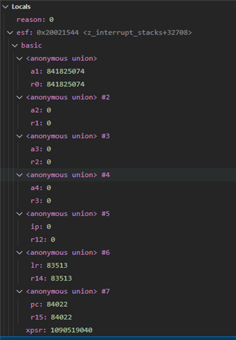

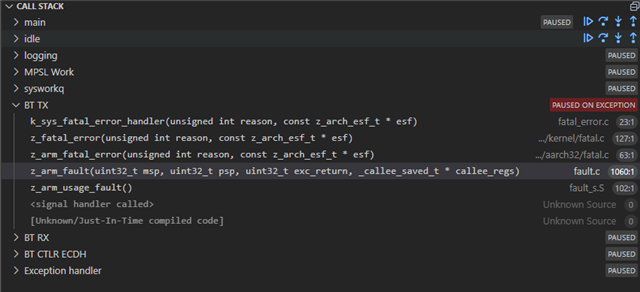

Edit: Managed to get more details since I moved to windows in hopes to solve it.  I was using MACOS.
I ran the debugger and set the breakpoint at fatal errors. The result is the following:
Thread 7 hit Breakpoint 2, k_sys_fatal_error_handler (reason=0, esf=0x20021544 <z_interrupt_stacks+32708>) at C:/ncs/v2.0.0/nrf/lib/fatal_error/fatal_error.c:23
Call stack:
The  [00:00:11.341,430] <err> mpsl_init: MPSL ASSERT: 112, 2152 erros stopped coming up by moving to windows, but now I only get this error:

I also want to clarify how the error happens. I have a loop that loops 5 times and each time calls the bt_central_send. what happens in the loop is:
use k_malloc to allocate memory for char buffer, use strcpy and strcat from sting.h to for the string. Then calles the send function with the string, and after the function is done it calls k_free on the buffer, then repeat until the 5 trings are sent. The receiver gets all the strings, they are all correct, and the function that sends returns, and its back to the main thread, the next thing after the function in the main thread is a k_msleep statement. I hope this info is enough to help trace the error.
Adding also: Sorry bare with me I am new to this.
I back-traced the error by doing this in the debug terminal:
-exec set $exc_frame = ($lr & 0x4) ? $psp : $msp
-exec set $stacked_xpsr = ((uint32_t *)$exc_frame)[7]
-exec set $exc_frame_len = 32 + (($stacked_xpsr & (1 << 9)) ? 0x4 : 0x0) + (($lr & 0x10) ? 0 : 72)
-exec set $sp =($exc_frame + $exc_frame_len)
-exec set $lr =((uint32_t *)$exc_frame)[5]
-exec set $pc =((uint32_t *)$exc_frame)[6]
-exec backtrace
The output was the following:
#0 z_impl_sensor_sample_fetch (dev=0xfffffeb0) at C:/ncs/v2.0.0/zephyr/include/zephyr/drivers/sensor.h:510
#1 sensor_sample_fetch (dev=0xfffffeb0) at zephyr/include/generated/syscalls/sensor.h:85
#2 pressure_sensor_read () at ../src/sensor_app.c:130
#3 0x0001475c in main () at ../src/main.c:64
which is right after the delay I mentioned before, so it goad like this:
