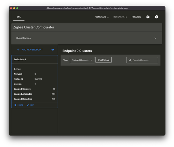

Hi Nordic Guys,
hope you can help following issue (I think the issue is still mentioned in Ticket https://devzone.nordicsemi.com/f/nordic-q-a/87410/corrupt-matter-zcl-file-generation-matter-template-project, Case ID: 288305).
I try to extend the matter-template example from the nRF SDK. Out off the box the example compiles, build and links The application can be copied to the nRF5340DK board and works.
If I add a new endpoint, like it is described in https://developer.nordicsemi.com/nRF_Connect_SDK/doc/latest/nrf/ug_matter_gs_adding_clusters.html#ug-matter-creating-accessory and let the generator.py script do its work, the result is an unbuild-able application.
See the following build-output:
/Users/bennynestler/workspaces/matter/nRFConnect/matter-template/src/zap-generated/endpoint_config.h:570:3: error: conversion from '<brace-enclosed initializer list>' to 'EmberAfDefaultOrMinMaxAttributeValue' is ambiguous

The error repeats several times as result of the inclusion of header files.
  • What happens if you save the template.zap file, quit the zap tool and reopen the template.zap file??
    But in your picture the number of enabled clusters is also wrong (you don't have 26 enabled cluster but only 15), isn't it?
    I'm working on a MacBook Pro M1 Max.

    And a new created matter-template leads to this view in zap tool
    If I save, close, and reopen it then it looks the same. Same amount of clusters and everything.
    When comparing your output with mine I see that you get errors about reading xml files, due to unknown extension files. Did you install nRF Connect SDK manually or using Toolchain Manager? If you installed it manually, did you make sure to install all python requirements?

  • Hi
    I removed my SDK v2.1.0 with the Toolchain Manager (and manually, because the Toolchain Manager times out ("Removing ... ") and moved some files to an new Directory "toBeDeleted").
    After the clearing I reinstall the SDK v2.1.0 and rebuild the zap tool with following tweaks:
    - nvm v0.39.1
    - node v18.11.0
    - npm v8.19.2
    1.) cd to /opt/nordic/ncs/v2.1.0/modules/lib/matter/
    2.) bootstrap the zap tool with ./scripts/tools/zap/run_zaptool.sh
    --> Error occurs due to an openSSL issue
      opensslErrorStack: [ 'error:03000086:digital envelope routines::initialization error' ],
      library: 'digital envelope routines',
      reason: 'unsupported',
      code: 'ERR_OSSL_EVP_UNSUPPORTED'
    2.1) Fix the error by setting an environment variable
    export NODE_OPTIONS=--openssl-legacy-provider
    2.2) (again) bootstrap the zap tool with ./scripts/tools/zap/run_zaptool.sh
    --> zap tool will be compiled but cannot be started because of the openssl-legacy-provider option (set before in NODE_OPTIONS)
    ⇝ electron: --openssl-legacy-provider is not allowed in NODE_OPTIONS
    2.3) export NODE_OPTIONS=
    3.) (again) bootstrap the zap tool with ./scripts/tools/zap/run_zaptool.sh
    --> zap tool is compiled and will be started and crashes because of an (arm64) sqlite3 issue
    3.1) cd to /opt/nordic/ncs/v2.1.0/modules/lib/matter/third_party/zap/repo
    3.2) npm uninstall sqlite3
    3.3) npm install sqlite3 --build-from-source --target_arch=arm64 --fallback-to-build
    3.4) cd to /opt/nordic/ncs/v2.1.0/modules/lib/matter/
    4.) (again) bootstrap the zap tool with ./scripts/tools/zap/run_zaptool.sh
    bennynestler@MacBook-Pro-von-Benjamin(arm64) /opt/nordic/ncs/v2.1.0/modules/lib/matter % ./scripts/tools/zap/run_zaptool.sh ~/workspaces/matter/nRFConnect/template/src/template.zap
    ARGS: -i /Users/bennynestler/workspaces/matter/nRFConnect/template/src/template.zap
    🚀 Executing: git log -1 --format={"hash": "%H","timestamp": %ct}
    🔍 Git commit: a94875d430d199ece002ab5bd971fdb78305fd4e from Fri Aug 12 2022 20:21:11 GMT+0200 (Mitteleuropäische Sommerzeit)
    🔍 Current src hash: h2euTBRFmUDzrR/ddxfwDvNx4Qk=
    🔍 Current src-shared hash: rF1YqWFjnJ5QZptyJBjTBuZ/z6M=
    🔍 Previous src hash: h2euTBRFmUDzrR/ddxfwDvNx4Qk=
    🔍 Previous src-shared hash: rF1YqWFjnJ5QZptyJBjTBuZ/z6M=
    👍 There were no changes to front-end code, so we don't have to rebuild the SPA.
    🚀 Executing: npx tsc --build ./tsconfig.json
    🚀 Executing: npx copyfiles -V ./src-electron/**/*.sql ./dist/
    unglobed path: ./src-electron/db/zap-schema.sql
    copy from: ./src-electron/db/zap-schema.sql
    copy to: dist/src-electron/db/zap-schema.sql
    🚀 Executing: npx electron /opt/nordic/ncs/v2.1.0/modules/lib/matter/third_party/zap/repo/dist/src-electron/ui/main-ui.js --logToStdout --gen /opt/nordic/ncs/v2.1.0/modules/lib/matter/src/app/zap-templates/app-templates.json --zcl /opt/nordic/ncs/v2.1.0/modules/lib/matter/src/app/zap-templates/zcl/zcl.json -i /Users/bennynestler/workspaces/matter/nRFConnect/template/src/template.zap
    🔧 Using state directory: ~/.zap
    {"level":40,"time":1666253418767,"pid":41112,"hostname":"MacBook-Pro-von-Benjamin.fritz.box","name":"zap","msg":"Check type contradiction in XML metadata for ColorControlOptions with type BITMAP8"}
    {"level":40,"time":1666253418768,"pid":41112,"hostname":"MacBook-Pro-von-Benjamin.fritz.box","name":"zap","msg":"Check type contradiction in XML metadata for LevelControlOptions with type BITMAP8"}
    {"level":40,"time":1666253418768,"pid":41112,"hostname":"MacBook-Pro-von-Benjamin.fritz.box","name":"zap","msg":"Check type contradiction in XML metadata for BarrierControlBarrierPosition with type INT8U"}
    {"level":40,"time":1666253419054,"pid":41112,"hostname":"MacBook-Pro-von-Benjamin.fritz.box","name":"zap","msg":"Attempting to insert cluster extension for a cluster which does not\n            exist. Check clusterExtension meta data in xml file.\n            Cluster Code: 0"}
    {"level":50,"time":1666253419418,"pid":41112,"hostname":"MacBook-Pro-von-Benjamin.fritz.box","name":"zap","msg":"Tray not created, icon does not exist: /opt/nordic/ncs/v2.1.0/modules/lib/matter/third_party/zap/repo/dist/src-electron/icons/zap_32x32.png"}
    {"level":30,"time":1666253419610,"pid":41112,"hostname":"MacBook-Pro-von-Benjamin.fritz.box","name":"zap","msg":"Init message received: WebSocket initialized handshake.. Responding."}
    {"level":50,"time":1666253419635,"pid":41112,"hostname":"MacBook-Pro-von-Benjamin.fritz.box","name":"zap","msg":{}}
    {"level":30,"time":1666253420230,"pid":41112,"hostname":"MacBook-Pro-von-Benjamin.fritz.box","name":"zap","msg":"Loading project(template.zap)"}
    {"level":30,"time":1666253420274,"pid":41112,"hostname":"MacBook-Pro-von-Benjamin.fritz.box","name":"zap","msg":"Loaded project(template.zap) into database. RESP: {\"sessionId\":1,\"sessionKey\":\"E6YW8pebXJV1ufBKAWS7GMldpwFG8hpa\"}"}
    {"level":30,"time":1666253420319,"pid":41112,"hostname":"MacBook-Pro-von-Benjamin.fritz.box","name":"zap","msg":"Init message received: WebSocket initialized handshake.. Responding."}
    {"level":50,"time":1666253420330,"pid":41112,"hostname":"MacBook-Pro-von-Benjamin.fritz.box","name":"zap","msg":{}}
    5.) Be happy about a working zap - tool Slight smile
