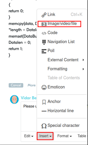

  • Please upload your full project as a .zip file here.
    Here is how you upload attachments:
