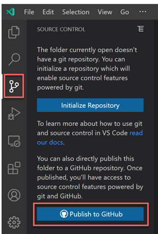

- Click in the Source Control Management (SCM) icon, and I will see a button that says Publish to GitHub:
However, this is not what I see, regardless of which project I open - I see the following, with no option to publish anything to GitHub:
I assume I have missed a step along the way.

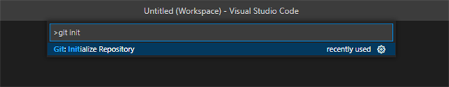

    When using Git with a new project, the first thing to do it is to initialize a repository. This can be done in the command line with git init, or in VS Code through the command palette: Ctrl+shift+p --> Git: Initialize Repository
    This creates a .git folder in your working directory, which VS Code will recognise and display in the source control tab you were looking at earlier:
    You can then start adding files and committing changes. To upload your project to a remote repository such as GitHub, you can follow one of many guides online.

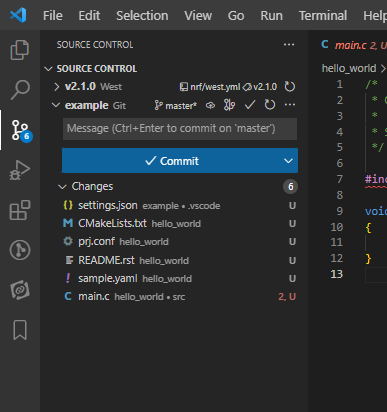

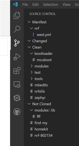

    The reason your source control tab didn't look like your first screenshot is because the NCS codebase itself is managed by source control too, and the nRF Connect for VS Code extension displays this in the "West" section.
    As you might know, Zephyr has a "swiss-army knife" tool called West, which among other things has source control features. These features, controlled by a West manifest, are useful for managing projects that depend on multiple Git repositories, but are not needed for normal application development. Feel free to ignore and collapse that section (as I've done above).
