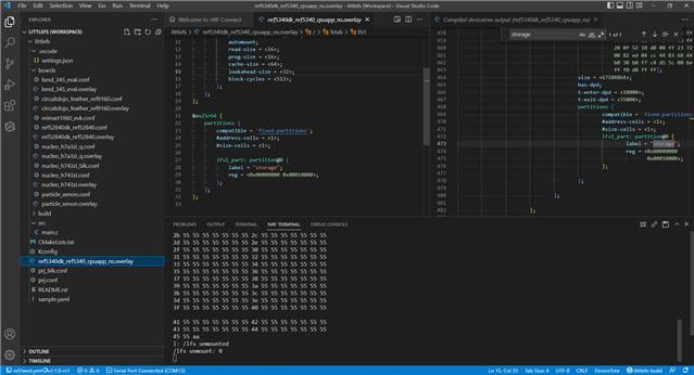

  • Hi Mark,
    As per your provided information, I have now included the overlay file. I can still build, flash and see complete output. Snapshot from VS Code showing output, the overlay file in the app directory and the compiled DTS is attached.
    *Just a small note, I was not able to extract your complete zip directory as it was complaining about "too long" names. Nonetheless, our project structure is same: starting from little-fs sample and then updating DTS through overlay.
    VS Code Snapshot
    Naeem

    This was solved by placing the downloaded zip file in the c:/ and then extracting it (otherwise it was very long path, containing c:/user/username/downloads/). Moreover, files in the build folder can have long names depending how you named your build folder.
    Nonetheless, I was able to extract your project and compare with mine. Interestingly the projects were similar, and now I know why you were not able to see the output. I am able to correctly build, flash and see output from your project.
    The problem (in fact not the problem, but confusion / mistake) lies in the build process. I have seen that you built the project for "nrf5340dk_nrf5340_cpuapp_ns", which means that your application is built for non-secure domain, and a trusted firmware (TF-M) will be included that will provide security by separation.
    You can read more about Trusted-Firmware here. If you are interested to build for NS domain, you can look at samples which include TF-M.
    At this time, to build, flash and see the output, you may use "nrf5340dk_nrf5340_cpuapp" as your build target, and it will be done.
