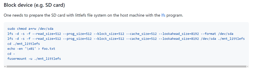

    I do not have a SDCard with me, but looks like the formatting problem of the card.
    (Formatting of SD card)
