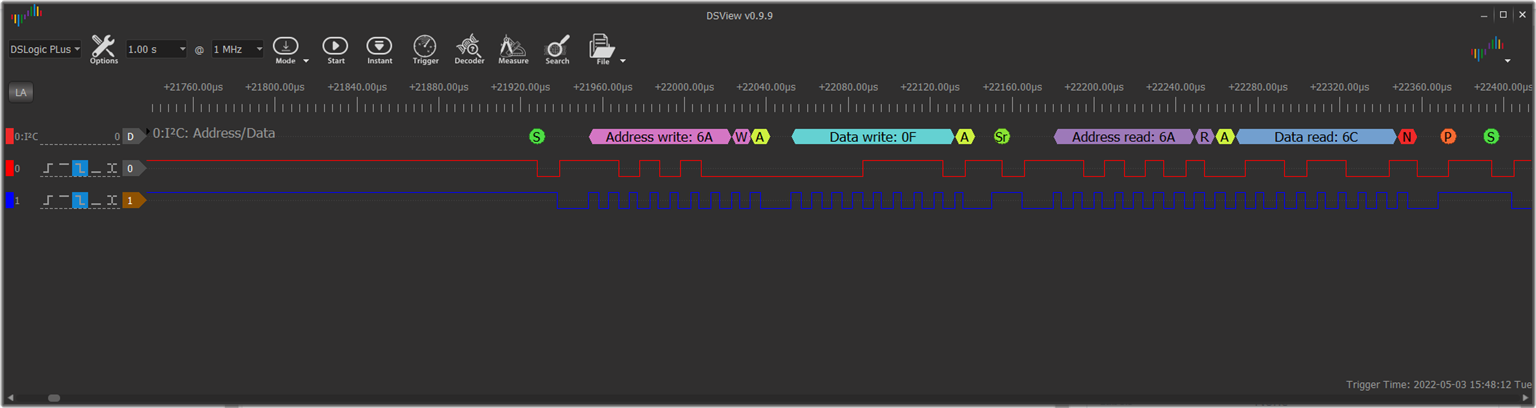

We tried communicating with an I2C sensor (LSM6DSO Evaluation kit) that is operating correctly when run with our verified drivers on nRF5 SDK (17.1.0) and we get back a correct response ( we are reading the device ID and data correctly ) which has been verified so our hardware connection is correct (as seen in the capture below ).

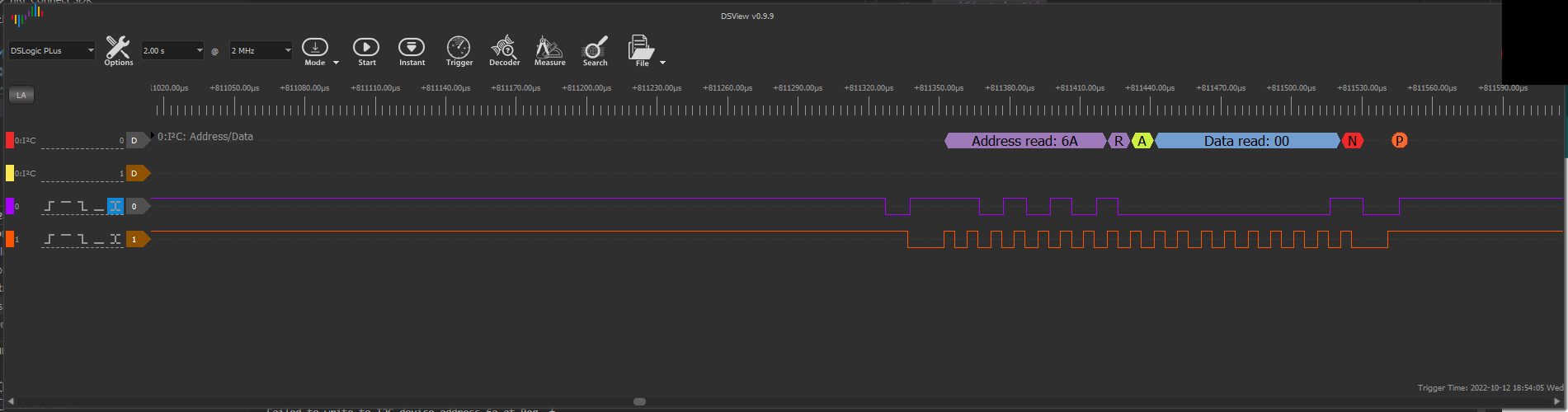

And the scope from the logic analyzer shows that only the second command (i2c_read_dt) was executed:
What is the issue here? We have tried running the same code in different projects with various i2c commands( i2c_write_read , i2c_burst_read etc. ) but got the same results.
Are we missing something? It seems that we followed the exercise steps exactly and our hardware connection has been verified to work correctly.

    I have found the reason all the attempts to communicate via I2C failed,
    I had to add the property bias-pull-up to my pinctrl configuration used by my i2c node (using overlay)
    For anyone else having the same issues here is the overlay code:
    &pinctrl {
        i2c0_default: i2c0_default {
    		group1 {
    			psels = <NRF_PSEL(TWIM_SDA, 0, 26)>,
    				<NRF_PSEL(TWIM_SCL, 0, 27)>;
                bias-pull-up;
