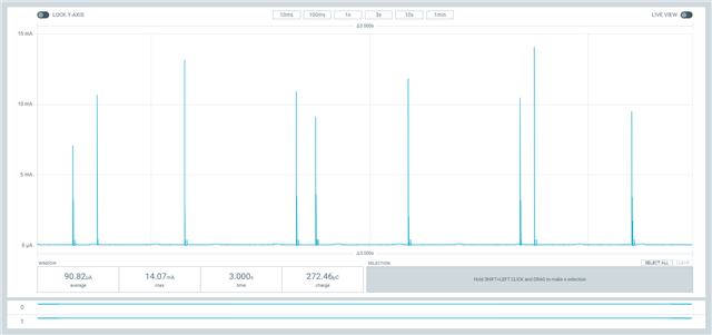

  • Ok, I now have a PPK II which makes measuring current a lot easier.
    I can confirm that on our hardware I still see ~1 mA of current with the RTC at 1000 Hz. But at 500 Hz I get about 90 uA with occasional large spikes...

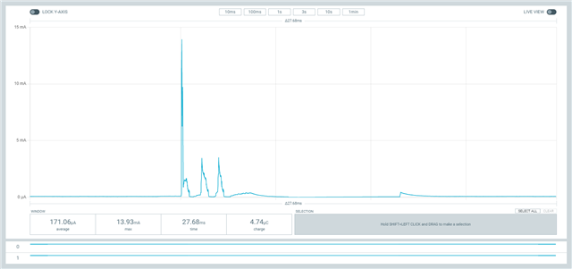

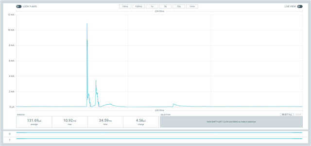

    Those spikes, closeup, look like this
      or sometimes this
    So it looks like *something* turns on with the big spike, then triggers one or more times before turning off again.

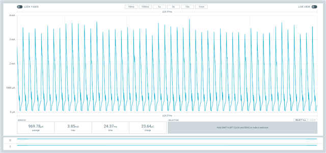

    The 1000 Hz RTC version looks like this
    Which seems to just be the 3 mA spikes, at 2 kHz.

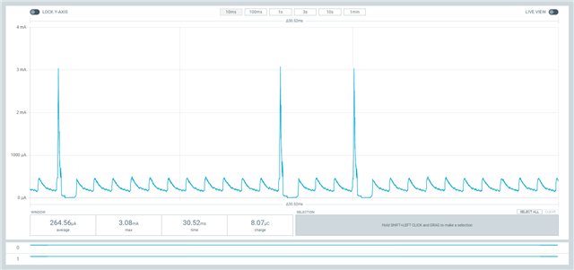

    At this point it looks like it must be our hardware doing this, except I can get sort of similar behaviour on my dev kit, by sleeping in a loop for a few milliseconds. Sleeping 1 ms in a loop looks like this
    Those small sawtooth peaks are at about 1000 Hz, so correspond to the CPU waking up and immediately sleeping. Those bigger 3 mA spikes look similar to what I get on our board though, seemingly at random intervals...
    I don't have a signal generator to hand, so will try the dev kit on Monday to see if I can reproduce the 1000 Hz behaviour on the dev kit.
    In the mean time - any idea what those 3 mA spikes might be? Particularly on the Dev kit current profile?
