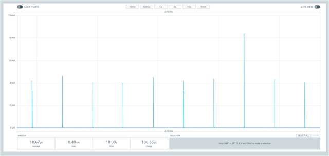

    I've tried my interrupt test code on the dev kit, and now get something like I was getting on our custom hardware.

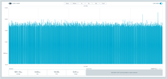

    Without the Signal Generator connected, I get ~18 uA with a spike every second when the CPU wakes up and immediately goes back to sleep. That's pretty much what I expect, although I'll double check the current figure.

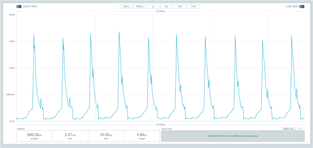

    With the sig gen connected and at 1000 Hz, I get about 580 uA, with the same sort of 3 mA spikes as I was getting before - except these are at 1 kHz, which matches the sig gen.
    Zoomed in it looks like this
    So it looks like I get similar behaviour on the dev kit to what I get on our own board. But the spikes are at a lower frequency, so the overall current consumption is a bit lower.
    ETA: current consumption increases even more if I change the gpiote interrupt config - In my test code I had set the pullup to NRF_GPIO_PIN_NOPULL and hi_accuracy to false while trying to get to the bottom of the current draw.
    Setting the pull back to NRF_GPIO_PIN_PULLUP I'm now getting just under 650 uA, and setting high accuracy mode to true it jumps to 1.4 mA.
