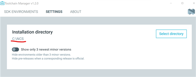

  • Hi Andy,
    Could you try reducing the path length from C:/Users/Andy/OneDrive/Desktop/andy/devel/samples/nrf_dm
    to something smaller? eg. C:/ncs/vsc/samples/nrf_dm or similar?
    What is your toolchain manager path, as shown below:
    Best Regards,
    Priyanka
  • That did not help
    Log below
    My Toolchain Manager path is C:\
