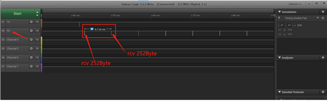

      According to your modification, 252 bytes work fine。On the tx side, I'm sending data in the send success callback, which is a huge gap every 252 bytes,About 6.7 ms,How to reduce every 252 bytes gap?As shown in the picture below
    1. Don't print in the event_handler. This applies to both PRX and PTX project.
    This is because the default setting is that you log in-place.
    You can override this by setting:
    "CONFIG_LOG_MODE_DEFERRED=y"
    2. Your PTX seems to send only when flag "ready" is set. However, the main loop also includes a k_sleep():
    if (ready) {
    	/* Send logic here */
    k_sleep(K_MSEC(1000));
    Try changing the k_sleep(..) to a k_cpu_idle() call instead.
