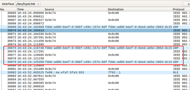

    Below is the Sniffer trace of the issue which i am facing. In the sniffer trace, the issue arises  between  time slot of 16:43:20 (packet no: 3318)  -  16:44:00 (packet no: 39666). There is no communication after time 16:43:24.125260 (packet number: 38879).

    Sorry about the late reply. Unfortunately we haven't been able to track down what causes this from your sniffer trace, since it seems like the end device still transmits data to the parent after packet 38879 as well, just not the data you've set it up to transmit, right?

  • it seems like the end device still transmits data to the parent after packet 38879 as well, just not the data you've set it up to transmit, right?
    My end device is transmitting at data rate of 100ms with the help of hardware timer interrupt triggering at 100 ms. When my device gets disabled suddenly (i.e thread state 1), I am executing timer stop function to stop publishing data at 100 ms. So I thought the packets which are getting transmitted (after 38879) could be of re-transmission attempt from mqtt-sn protocol, but that also shouldn't happen because I can see my device state as 1 (disabled) at that point of time as well.
