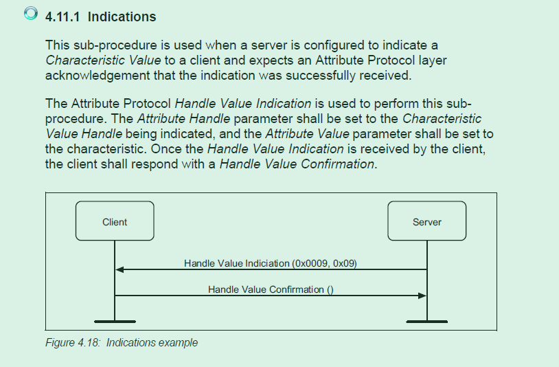

I have realized my idea with Notification. It works, but not perfectly. Because sometimes when I release a button, I wont get the notification.
I would like to get something like an ACK, when the information is recieved on the nRF51 board.
So I will have to use Indication instead of Notification.
image description
I know there are a lot of examples, which are using Indication(BPS, CGM, GLS, HTS).
The thing is, in this examples the data will be send form the nRFBoard to the Client. But I want the other way. I want to send data from mobile device to nRF51 DK.
Are there any examples where the data will be send form mobile device to nRF51Board with Indication?
Or could me somebody explain how I will get into the write_handler() function when I use Indication?
Do I have to call the write handler, when I get the confirmation?

    On the nRF51 side, the difference when it's receiving notification or indication are small. The stack handle the ACKing for the application. So on the application it's almost the same, you receive BLE_GATTC_EVT_HVX. Only the type in ble_gattc_evt_hvx_t are different when you receive the event.
    I don't think you will receive any call back on the app on the phone when the indication is confirmed (unlike on nRF51 side). But there is a call back when the notification/indication is sent (onNotificationSent ) have you used it ?
    I don't quite understand "up_write_handler", what do you plan to do with that ?
  • Hmm there is no call back when indication is confirmed? So I have a other solution in my mind. I could set up 2 characteristics. One for the data, which will give me information which button is pressed and is the button pressed or not. And the other characteristic would be like an ACK. Everytime I get a notification from the app, I would send on the other characteristic a notification, that the data is recieved.

  • I think it's a good solution. Just a workaround when Android doesn't have the call back for indication has been confirmed. I am not sure what's the case on iOS though.
    But why do you want to have the server on the phone ? Why not having the server on the nRF51, then you can do a reliable write from the phone, which have more control over what is received on the nRF51. Have a look here.
