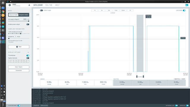

  • Hello  , it seems I have the same issue. My PPK2 measures 8Amps for an GSM Module!?!
    Can you help me find my calibration values? My board is:
    PCA63100

  • What GSM module is this exactly? What operating voltages does it support, how are you supplying it and measuring it? I need more information from your side before reporting this internally, as these calibration values don't seem outlandish to me.

  • Hello  and thank you for your reply.
    I did more tests to simplify the setup and I would like to share with you what I observe, and why I think there is something wrong here.
    I am using a board very similar to the Adafruit Feather S2. See here page 297
    https://cdn-learn.adafruit.com/downloads/pdf/adafruit-esp32-s2-feather.pdf
    I am running the below RGB Blink example:
    #define RGB_BUILTIN PIN_NEOPIXEL
    void setup() {
    // No need to initialize the RGB LED
    // the loop function runs over and over again forever
    void loop() {
    neopixelWrite(RGB_BUILTIN,RGB_BRIGHTNESS,0,0); // Red
    delay(1000);
    neopixelWrite(RGB_BUILTIN,0,RGB_BRIGHTNESS,0); // Green
    delay(1000);
    neopixelWrite(RGB_BUILTIN,0,0,RGB_BRIGHTNESS); // Blue
    delay(1000);
    neopixelWrite(RGB_BUILTIN,0,0,0); // Off / black
    delay(1000);
    And when I give 5V between VBUS and GND the current spikes up at 8A. The strange thing is that when I lower the supply voltage then the current goes to zero, which is also strange... With a USB tester I can see that the consumption is around 20-30mA for this setup.
    I noticed a similar issue in another thread but there is no resolution:
     nRF-PPK2 gives unreliable current readings
    Thank you for the help with my ppk2
    Spiros

  • Hello @Simonr,
    Any update with my issue?
    I am stuck at the moment and I can't use my PPK2
    Thank you.
  • Hi
    Sorry for the late reply, I've been otherwise engaged the last few days, but I have now asked internally for access to the calibration data for your specific PPK2. I'll let you know as soon as I get them.
    Out of curiosity, what software have you used with the PPK2 to take these measurements? This doesn't seem like something our Power Profiler application would cause.
    Simon
  • I got the calibration values almost straight away, here they are. Note that they're in a different format than what you get from the EEPROM tool used:
    R: [1008.3334, 102.8103, 10.5112, 0.9916, 0.0573]
    GS: [0.0, 172.3044, 27.2495, 3.7972, 0.1114]
    o: [175.19716282894737, 122.19786235834067, 104.669313504667, 79.98335665332979, 140.34804167003148]
    s: [-9.7e-08, -8.42e-07, -8.243e-06, -9.6815e-05, 0.001204936]
    i: [2.78e-07, 2.242e-06, 9.8943e-05, -0.000108232, -0.005116542]
    GI: [1.0, 0.953, 0.9425, 0.927, 0.9383]
    Simon
