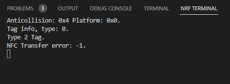

Console output from NTAG216 tag:
Anticollision: 0x44 Platform: 0x0.
Tag info, type: 0.
Type 2 Tag.
NFC Transfer error: -1.
Console output from Mifare Classic tag:
Anticollision: 0x4 Platform: 0x0.
Tag info, type: 0.
Type 2 Tag.

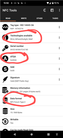

    When reading the tag with the "NFC Tools" Android app on a mobile phone, it reads the data in NFC Forum Type 2 format as shown in the screenshot below
    The anticollision request returns 0x44 just as in the tag_reader sample.

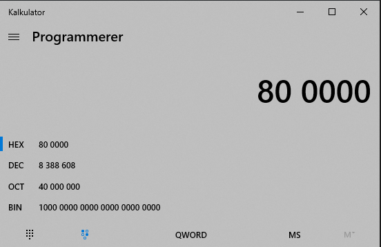

    I see that rx_error_check() is called from irq_process(), where the irq is generated using st25r3911b_irq_read(). This function returns status, which is either coming from a "data" array.
    The ST25R3911B_IRQ_MASK_CRC == 0x800000UL, so when st25r3911b_irq_read() should return something with this mask. Can you tell if the bit (see screenshot below) is coming from data[2]? If so, it would come from the SPI message, right?
