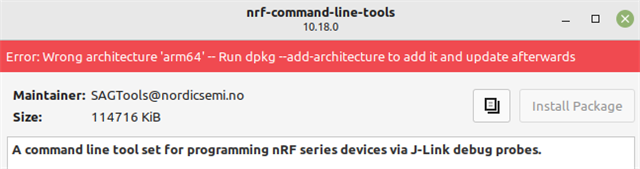

I am attempting to download v10.18.0 of the nRF command line tools for Linux x86 64. However, the .deb file provided is for arm64. Could you please fix this in the nRF command line tools download page? Or should I be installing in a different way?

Here is the link until it is fixed: www.nordicsemi.com/.../nrf-command-line-tools_10.18.0_amd64.deb
You might consider yourself lucky. A post here four days ago nRF Command Line Tools Error reported that it was broken on macOS, and downgrading to 10.17.0 fixed his problem
While 10.18.0 might work on linux, I have wasted half of today on the Windows version of it (my problem is that nrfjprog fails to load its DLL and gives "GetErrorInfo failed". Well, it does if you turn on logging, and then think to look at the (silently) created "log.log" file in the current directory.
For what it's worth, version 10.17.3 works for me on Windows.
