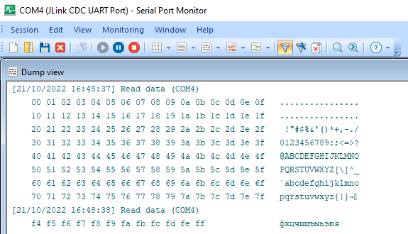

Libuarte_async_tx - loss of bytes while transferring to PC (with active softdevice 132, nrf52832).
I am transferring data received via ble to uart PC.
BLE MTU - 247, connection priority - HIGH (15ms).
I successfully receive data from ble, put it in the fifo, then take it out and send it to libuarte.
But less data comes to the PC than I sent (provided that the data was larger than 244 bytes).
Example: I send 256 bytes (00 - FF) from my smartphone, it will be 244 and 12 bytes.
output in RTT:
<info> app: uart_loop fifo_read: 244 bytes
<warning> libUARTE: Started TX total length:244, first chunk:244
<info> app: uart_loop fifo_read: 12 bytes
<warning> libUARTE: Started TX total length:12, first chunk:12
data on PC:
my code:

I have tried different settings but without success.
The transfer works successfully if you generate data locally, do not use bluetooth to receive data.
Maybe when data is received via bluetooth, does the libuarte_tx stop?
Ideas and advice? (I would be very happy to discuss and provide additional information)

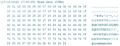

    And no matter how I changed the settings, on the PC I get fewer bytes than I sent.
    I created a separate project from our codebase that demonstrates this issue (ble_uart.zip).
    ble_uart.zip
    I hope to help and are willing to provide additional information upon request.
  • I rewrote the example without using libuarte (I only used nrf_drv_uart.h).
    Problem still exists.
    But, as soon as I disabled the debug terminal, the problem disappeared.
    I checked many times, and with the original project too.
    There is no problem if you do not connect a debug terminal.
    But there is a problem if the terminal is connected, even if it is disabled in the configuration (sdk_config.h NRF_LOG_BACKEND_RTT_ENABLED 0, NRF_LOG_BACKEND_UART_ENABLED 0, NRF_LOG_ENABLED 0).
    Can someone comment on why this is happening and suggest a solution that will allow using the debug terminal?
