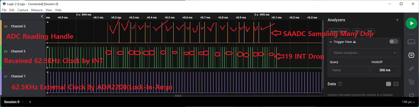

    This product uses an external ADA2200 (Lock-In-Amp) to generate a 62.5KHz clock (Logic Channel 7).
    This clock is input to the nRF52840 as an interrupt (Logic Channel 5).
    This interrupt does SAADC sampling through ppi (Logic Channel 3).
    According to the nRF52840 datasheet, the maximum sampling rate is 200KHz.
    I'm trying to do ADC sampling synchronized to a 62.5KHz clock. (Channel 7)
    However, as shown in the figure, 19 clocks per 100 INTs were dropped (Channel 5)
    But even worse, ADC Sampling only got 19 (Channel 3)
    This is a very serious problem. The most important function of my product is to perform ADC sampling in synchronization with the 62.5KHz clock.
    However, there are too many DROPs as shown in the picture below.

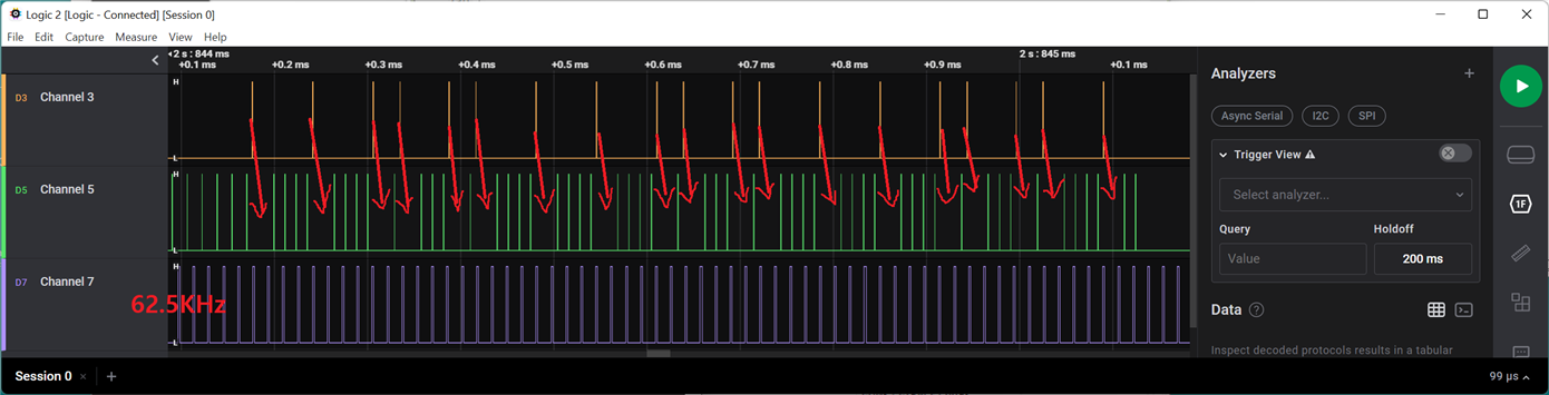

    Looking at the second picture,
    When ADC sampling is acquired, the next interrupt is dropped. 19 interrupts dropped, 19 ADC samplings acquired.
    The interval time of 62.5KHz is 16uSec. ADC sampling takes more than 16uSec.

    Even though you are sampling this at 62.5kHz, you should not need to execute an MCU interrupt at this interval. Much of the point of having PPI and EasyDMA is to offload the MCU for the real-time requirements, and instead the MCU only need to actively handle "lump" of data, not on a byte level, but on an array of data. So my suggestion here is that you change SIM_SAMPLES_IN_BUFFER from 1 to 10. Then the MCU will be interrupted every 6.25kHz to process 10samples, instead of 1 sample every 62.5kHz.
    Kenneth
