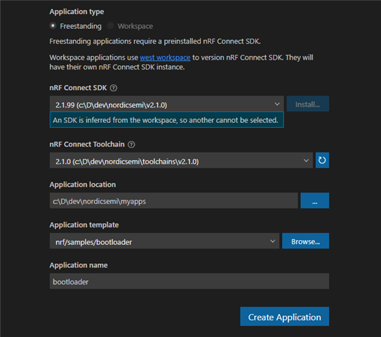

NRF samples don't work on sdk v2.1.0
I'm working with NCS v2.1.0 and Visual Studio Code, I tried to build nrf/samples/bootloader but always:
warning: attempt to assign the value 'y' to the undefined symbol IS_SECURE_BOOTLOADER
I can run all other  samples on zephyr/samples without issues, not sure if a missed of something or some configuration to allow CMakeList.txt or Kconfig definitions in sdkv2.1.0/nrf/ folder or maybe it is not allowed to use those definitions anymore, what am I doing wrong?, thanks.

  • Hi Maria, it is not my prj.conf, it is the example one :
    I just go to Create a new application->Application template-browse->nrf/samples/bootloader->select->Create Application->build
    Visual Studio Code version: 1.72.2 (user setup)
    NRF Connect for VS Code v2022.10.30

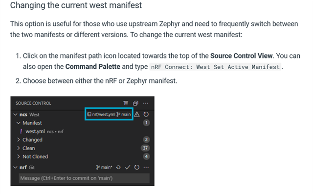

  • Ok, so knowing it must work(thanks Maria), I was looking at West Integration: https://nrfconnect.github.io/vscode-nrf-connect/connect/west.html
    and I did :
    and now I can create app with nrf/samples/bootloader and acces to symbol:
    CONFIG_IS_SECURE_BOOTLOADER=y
